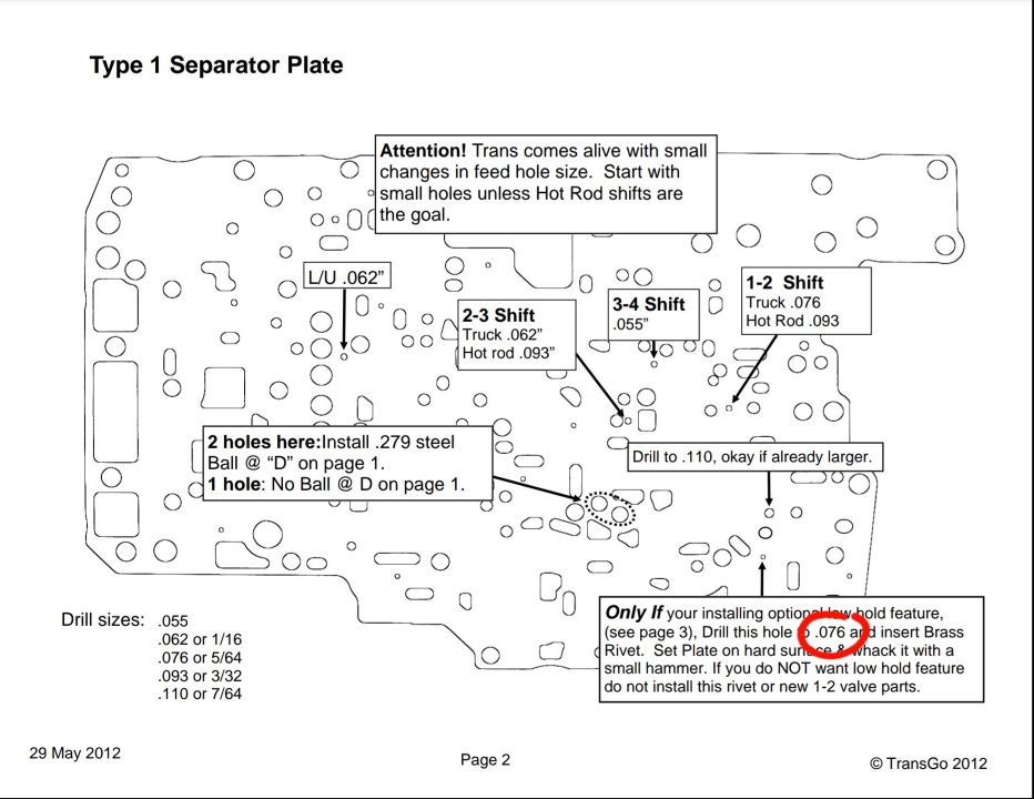

I did the transgo kit on my jeep, I went with full race the first time and hated the bone jarring shifts. I redid it and did the truck setting for the 1-2 shift and did the race shift for the 2-3 shift (Same size hole drilled in the separator plate). I also left the stock accumulator springs in place and didn't mess with them. Now the shifts are quick without barking the tires at WOT.
I did all the hot rod shift settings on mine. I installed the full kit. Worked well. Mine too would chirp my 33s on the 1-2 shift but the 2-3 was nice a crisp. If you daily it just do the truck shift settings for 1-2 like said.

You would need the trans go kit to fix the shift speed. The radesign kit basically replaces the factory shifter. The transgo kit does internal modifications to the trans including raising line line pressure over stock, drilling holes in valve body plate to increase fluid flow, changing various springs, etc. You could do one or the other or both, but they have different purposes.
