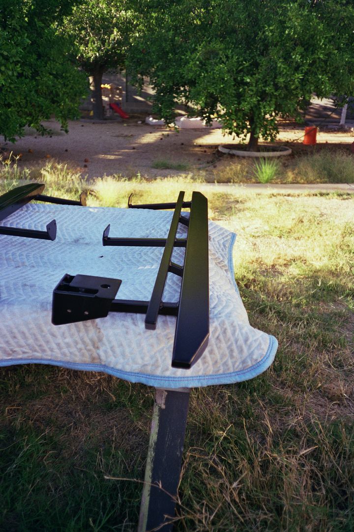

Yeah, my rockers are bad, really bad, this is the most recent pic I have of the passenger side (driver side is worse), and this was taken in November of December of 2018.
I just wasn't sure on any one way of attaching being better than another, the options out there kinda overwhelmed me, to be honest. We're probably going to start at the trailing end of the front fenders and work out way back to the rear tires and there will likely be a lot of rust removal, cleaning, and probably a combination of POR15, weldable primer, then regular primers used before bedlining that portion of the body. The rims are starting to look BAD as well and I'm half debating about cleaning them up as much as I can and putting some gunmetal paint on them, since appearance won't be so important any more and will be cheaper than powder coating (I'd rather do that then buy different rims that are at least wider, if not a a touch taller (17" max) too.
