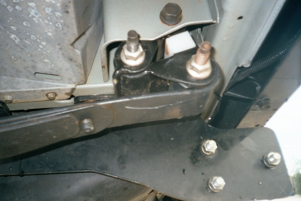

Looking for replacement rear springs and bump stops (one missing) for my '99 XJ.
Have complete 3.5" OME lift but rears seem to be flat, and feels/sounds like bottoming out on nearly any dirt road rut, bump or rock, even at very low speed. I did have probably 100# of gear in the back + spare tire rack on rear bumper, jack, rotopax (JRC). I've since unloaded but haven't test driven.
So, keeping it at 3.5" (33 x 10.50 w/4.56) can I get a recommendation on good spring packs and bump stops please? Just want to keep the height as is. The extra gear and tire rack need to be part of the equation I suppose.

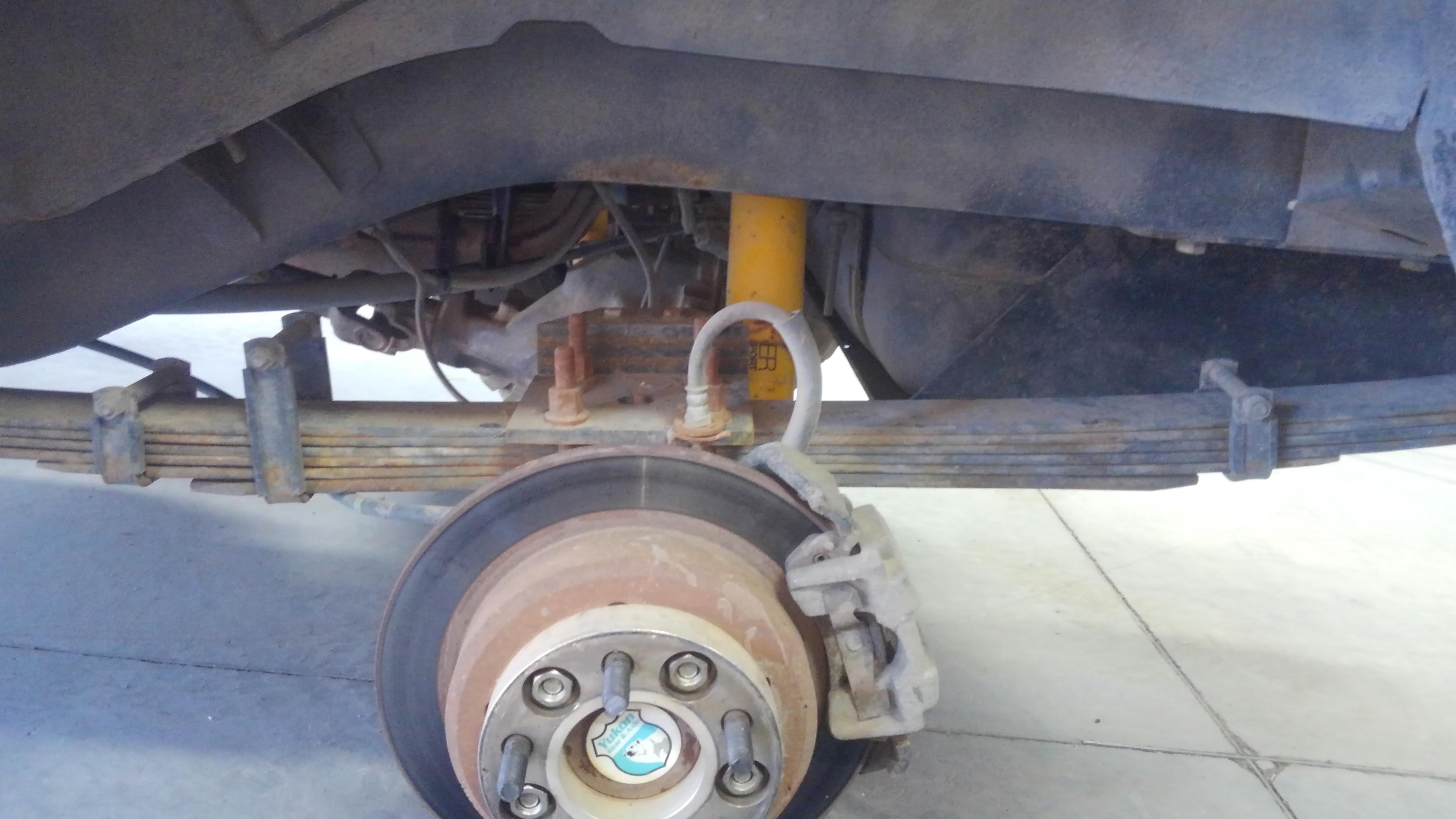

New pics.

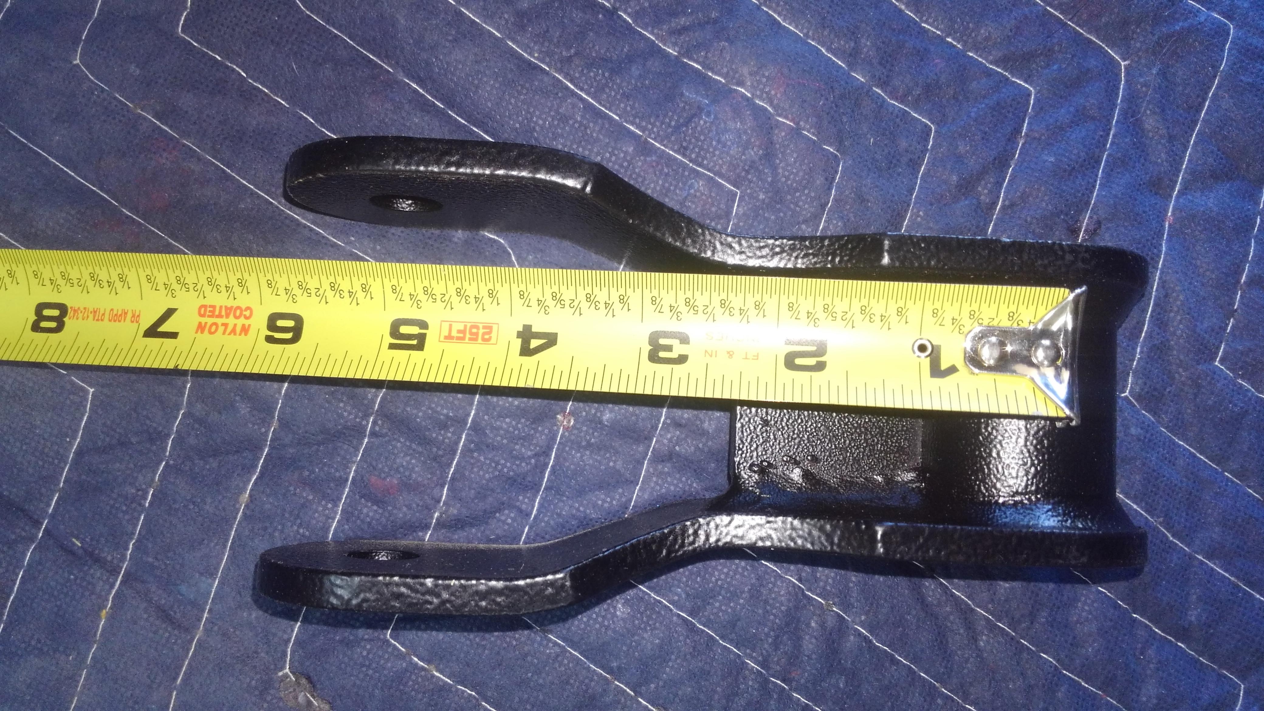

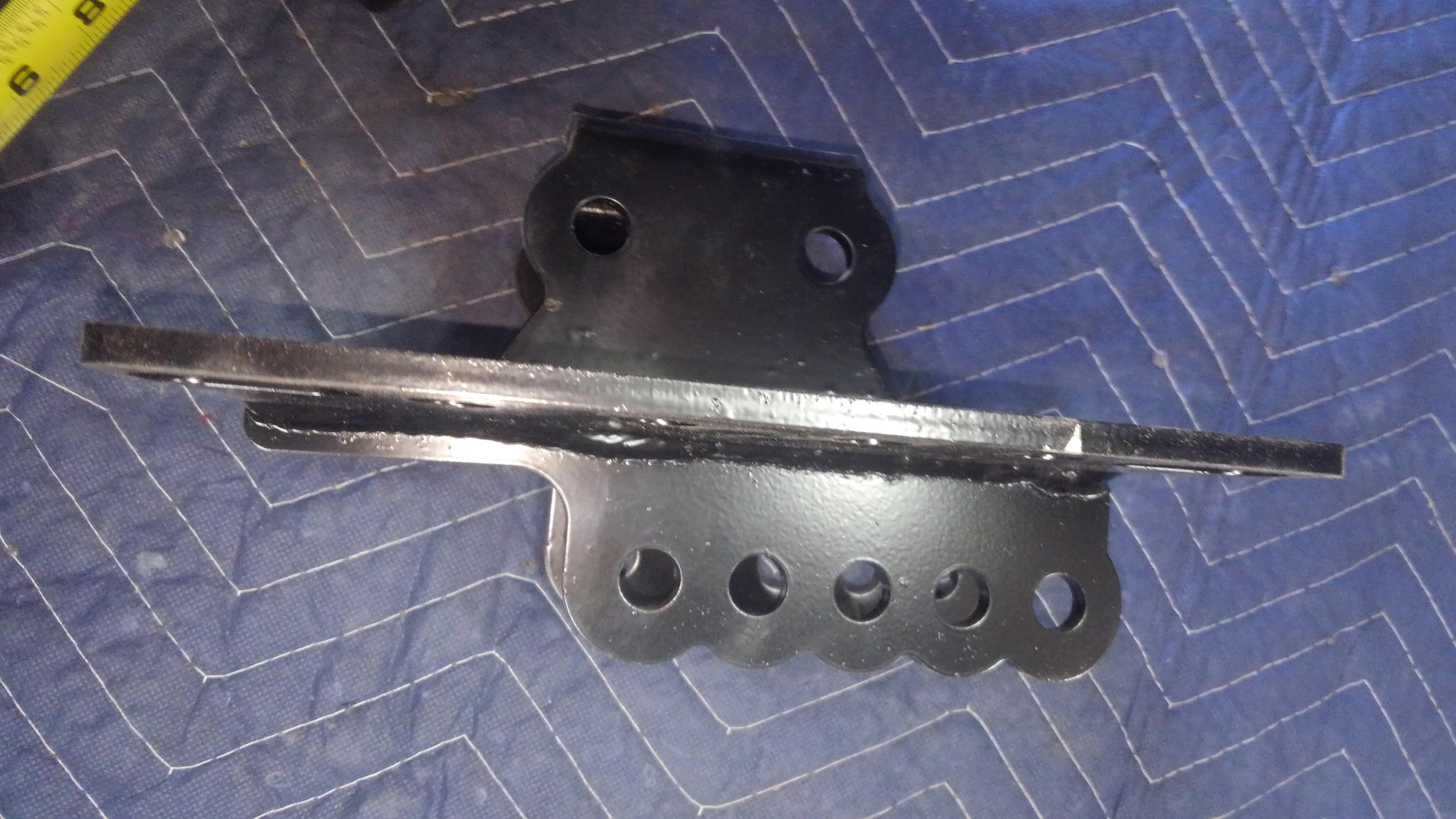

Wonder if either of these are worthwhile?

Ya man those look smoked to me...
I'm pretty happy with the IRO 3.5 leafs with add a leaf option. Be warned, the extra leaf is separate on delivery. Not overly hard to take the pack apart and put it in just, overly annoying.
Those new shackles will provide some more lift, but they are definitely beefier than the stockers and I'd throw em in when you install the new springs.
The shackle relocation brackets you got there will add some more lift too, and allow you to get the proper angle on your shackles. If I'm seeing them correctly they bolt in to the stock shackle location and in turn drop the new shackle mojnting location a few inches, thus creating more lift? Unless I'm seeing them wrong
For some reason they do look off to me, and I can't place it, maybe I just need sleep lmao! I'm a big fan of the SFR srb. While they are more work to install they are of the "no lift SRB" variety. Something it sounds like you could use instead of the ones ya got. It took some work to get the old crap out... being OCD I ended up dropping the gas tank and all that fun stuff. I don't think ida blown my self up grinding near the filler neck and vent tube.. but it was in the way too.
At 3.5 up front, the ass will definitely be up a bit with any new 3.5" leaf spring kit you throw at it (not to mention the shackles and SRBs ya got). Takes a few for it to settle down a bit, some added weight of a steal bumper and tire carrier speeds that up. Or just drive around with sand bags in the hatch!
You could always throw a spacer up front as well. Not sure how the rest of your suspension is set up or if thats doable or not, but a cheap way to level her out

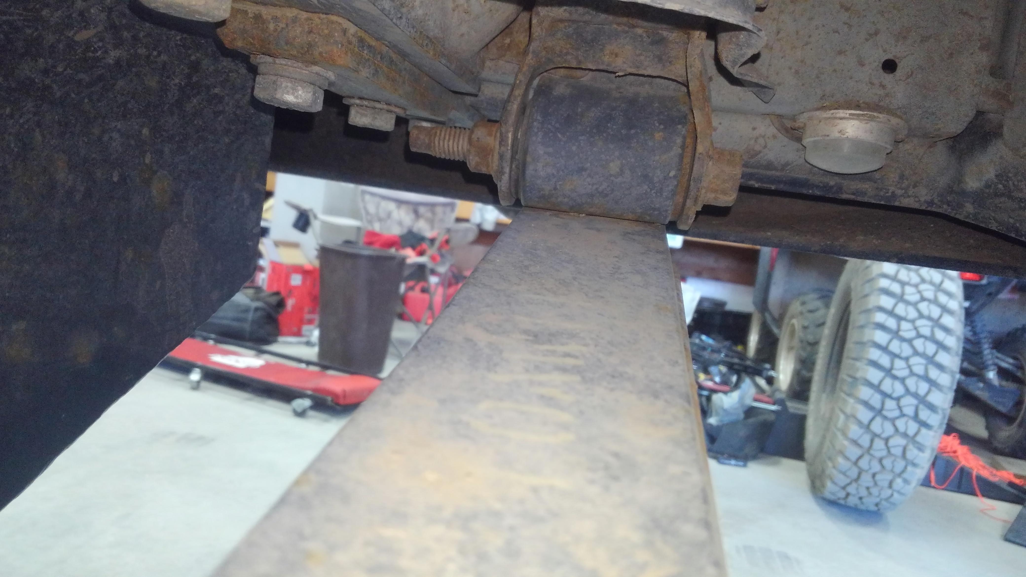

Your shackle box looks to be collapsed, but perhaps it just appears to be the case due to the close-up wide angle photo.
Oh, good call out... I'm on my phone and the pics are monstrous, I totally missed that. Ya man, that thing is fubared fosho.
I don't know that the Shackel Relocation Bracket you have will still be able to mate to that... as my long-winded post hinted to, the nonlift SRB might serve you better- now with the damage here makes even more sense, as you have to cut that box out to install them. StinkyFab makes a dope one, but there are also others... as I already said I'm happy with my purchase, its a stout design, perfect bends, and had great customer service through and through. Not trying to sound like I'm tryna sell ya something tho, so ya: no lift Shackle relocation brackets
Should be in your near future

Oh, good call out... I'm on my phone and the pics are monstrous, I totally missed that. Ya man, that thing is fubared for sho.
Impressive if it is actually collapsed. Ironman4x4fab SRB also looks very nice. Great that there are many choices.

Can someone post a picture of an OEM unmolested/damaged spring shackle for me to compare please? I'm just not seeing it.
Got a line on a '99 to pick some parts from so will check that one out when it warms up.

Its not a removable part... I mean, I removed mine but it took a Sawzall and grinder. Installed the no lift SRBs in its place. You can't replace with stock is what I meant
I will try to edit the pic

Pretty sure if you look at the box you can tell if it ain't right...
