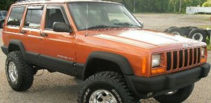

What it looks like right now by the pond
Now my plans are to take off all the door trim and go two tone
And what arrived at my house a few days ago after a long wait from overseas......

just to update, i ripped all my new OME lift stuff off and have gone to a 6.5" lift. I have my front and rear bumpers on now. Have to swap out brake lines, install my sye, and put on the sliders and she will be back on the road. Been a long time and only been able to do a little here and there but its almost done if this cold weather holds off.
Sye is in and drive shaft connected. Rear longer brake line installed and its back operational. Need to mount sliders then take off and have them bedlined. Plans are to swap in a D30 HP and a Ford 8.8 (4.10's) soon.
You can post facebook images here.
Right click the picture and Save Image URL, click the yellow block with the mountain on it in the tool bar and paste the link. Click OK.
6.5" Lift, 265/75/16 Bfg's on TJ rubicon rims, factory 3:55 gears.
Need to mount my JCR sliders then take off and have them bed lined. Plans are to swap in a D30 HP and a Ford 8.8 with 4.10 gears, then buy black rims and run 33" tires. So close but yet so far away from being done.
