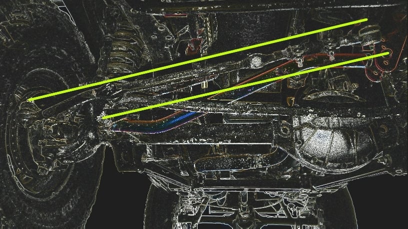

I need to adjust my caster because I have some bumper steer, the trac and drag link angles are very good, its not that. Toe in ive adjusted to FSM.

BTW, if your having bump-steer then your trackbar/steering link angles "are" off. Nothing else causes bump-steer.

I dont know what to tell you then, trac bar and drag link are dead on parallel. Maybe its squirrely from poor caster then, should be easily fixed after adjusting the upper link.
All I know is if I hit a bump she jumps a bit one way or the other.

Maybe bumpsteer isn't what your experiencing. Or could be track drag length difference

Zj steering linkage. Tracbar mount isnt too exagerated from stock if at all.

just noticed the picture.
My first question whts good about zj steering it appears to be some as stock xj.
I notice a pretty substantial difference in track bar and drag link. Though parralell the length difference may be great enough that the two bars swing in different arcs(paths)
Shit i just measured stock xj drag link is 5" longer than track bar.
I wonder if track bar bolt on the axle side is wobbled out and allowing it bump back and forth feeling like bump steer.
zj steering was an upgrade from the stock xj tie rod when I was going up smaller tire sizes. Its a solid tie rod vs the stock hollow toothpick. It will be replaced eventually but it works for now. Definitely worth carrying for a spare for anyone keeping stock geometry/mounting.
The trac bar axle side bolt is a good thought. I have had it marked with permanent marker to make sure nothing moved during my moab trip, nothing shows movement, but I will pull the bolt to check for sure. If Im lucky it is wallowed haha, SFR has a bracket Ive been wanting to upgrade to.
