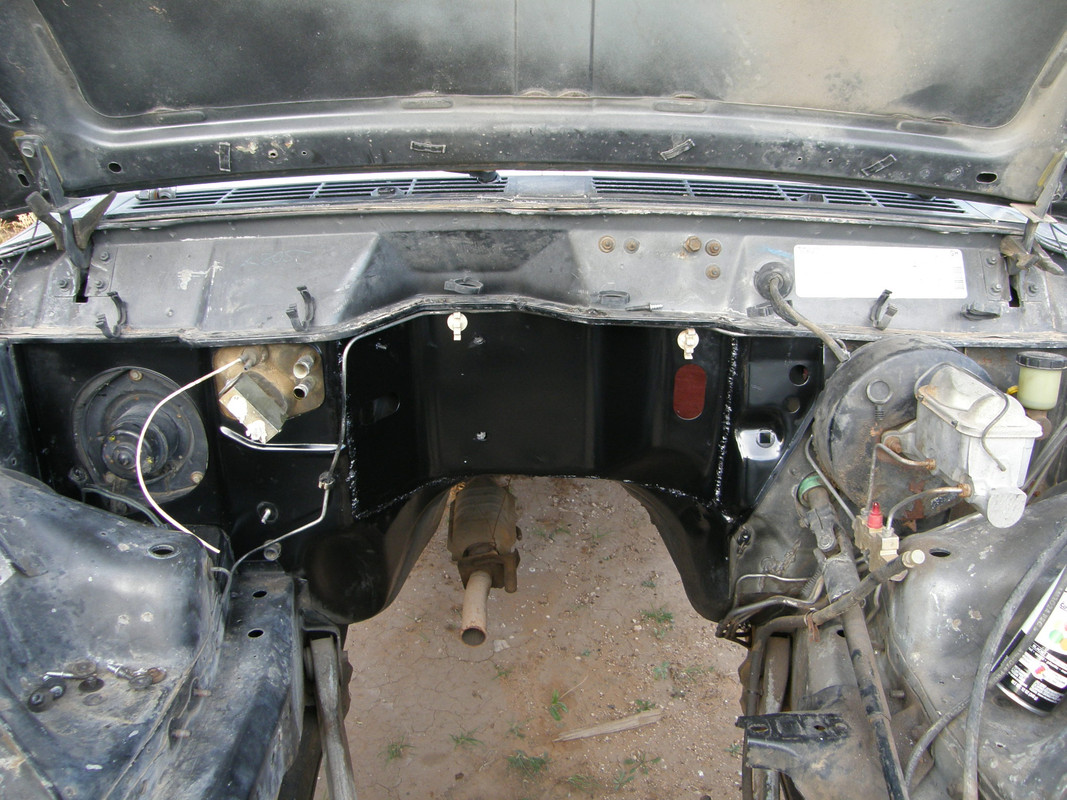

I have an 86 two door with a 4.0/AW4/231 in place of a 2.8/AX5/207. It can't be as much work as that was. The firewall and core support are the same for the most part in later models. What I'd like to do is leave the dash harness alone. I know the engine harness will have to change, as well as the computer, and it'll need accommodation for the TCM too. I'd be pretty happy if I could just replace everything forward of the bulkhead connector and run the existing fuse panel without having to splice anything. I'd be really happy if it looks like it came that way from the factory.

Had to run outside and check to be sure I wouldn't have to make that hole for the TCU, but it's there with a plug covering it. I know it changed size and shape at some point, getting larger sometime around 90-91. There's a recess behind the HVAC cabinet where the harness fits but I'm not sure I could fish the plug and all through there. It's worth a shot.
