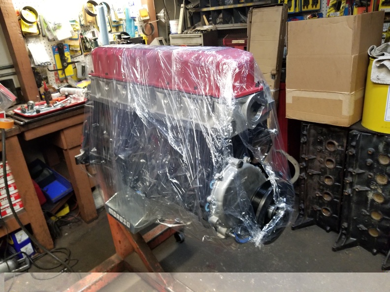

It's so pretty.
But we're going to talk about it at a later date. The cam for this motor is not back from being nitrided and Russ happens to be out of valve guide seals for the Edelbrock head, which are not the same as the standard 4.0.
So that's as far as we got. For those of you keeping score, that was ~11-13 hours of build time (2 days), and we started with all machined parts. Russ is super meticulous about assembly, which is why his lead time is so long.
But if you happen to be waiting for a motor, it's probably right here, in a mountain of machined blocks awaiting assembly.
