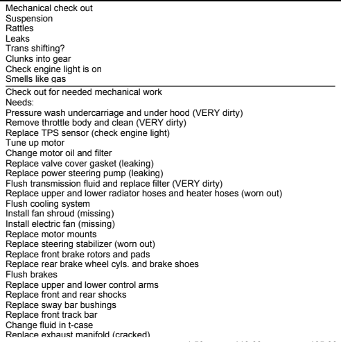

Before I stored it , I had it checked out at the local jeep dealership . I've attached their diagnosis. Part of me feels like the engine and / or should be rebuilt (hardly any power) but the other part of me feels like I should probably fix minor stuff like the leaky valve cover gasket and exhaust manifold and then re-evaluate from there.

Check what engine code it's throwing. Then address the front suspension so you can drive it. Get under there and look at and feel all the joints while someone turns the wheel back and forth. Look for play or things moving that shouldn't be like the trackbar mounts, or the power steering box loose on the frame.
The dealership list is probably pretty much spot-on. Looks like a lot of deferred maintenance and typical wear on an XJ. The missing fan shroud and e-fan being an interesting touch.
The one thing the dealership has listed that I might tackle differently is the power steering pump. Not having looked at it the dealership may be right, but odds are good that all you need to do is replace the o-ring that seals the tank to the pump. Doing this requires removing the pump from the engine, and from the dealership's perspective at that point you might as well be putting in a new pump, but if you are doing your own labor there is benefit in making the effort to keep costs down and an o-ring is substantially cheaper than a new pump.
Also note that there is often a direct correlation between worn out motor mounts and a cracked exhaust manifold (header). If you don't take care of the two of those at the same time then at least make sure you do the motor mounts before you take care of the exhaust lest you end up needing to take care of the exhaust twice.
Before you spend any money on control arms and track bar you need to decide on how much lift you intend to run and how/where the vehicle will be driven. At different amounts of lift different components will come into play. And you have lots of aftermarket options in that department. Be specific about your goals and you can get recommendations for what products are most likely to meet your needs.

Based on your feedback, I think I'm going to tackle (in order)
  • the battery (old one died on me shortly after I got the vehicle home
  • the valve cover gasket (to stop the incessant leak whenever I crank the engine)
  • exhaust manifold
  • motor mounts
  • take a look at what's going on with the power steering
After that point, the vehicle should hopefully be a bit easier to deal with (to change fluids, general maintenance, suspension etc).
