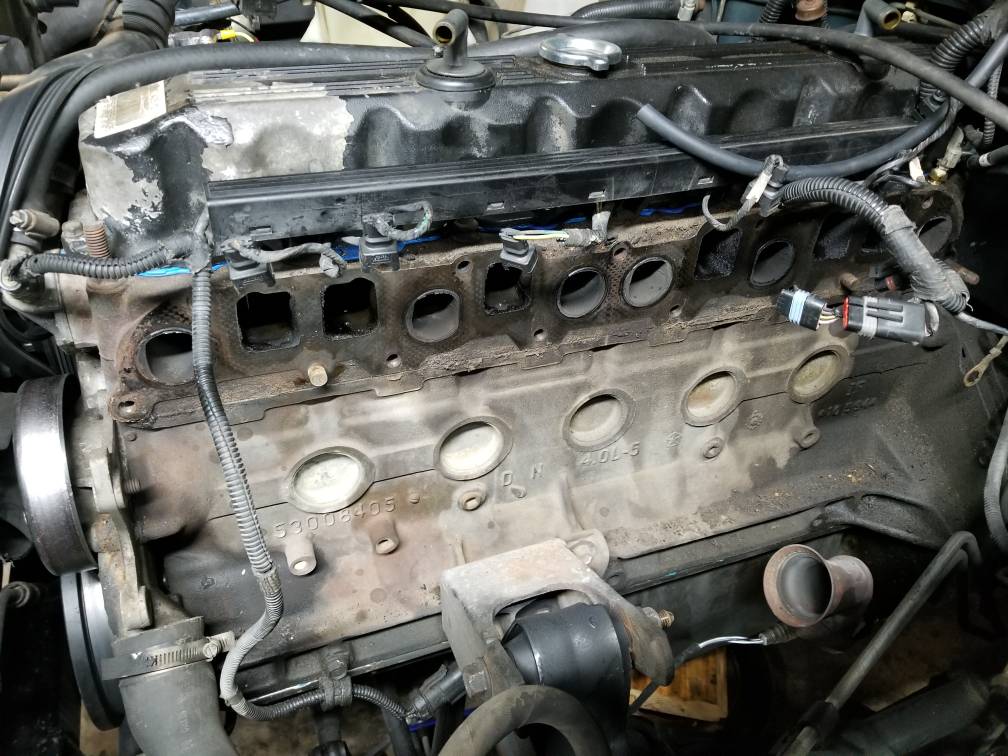

I'd kill for yalls mileage. Stock 95 XJ (upcountry height) w/235s and I'm averaging 13 mpg lol.
Cracked header replacement is scheduled for this weekend.

Yes, you have some work to do!
If you have not already replaced the Oxygen Sensor, replacing it with the manifold is about as easy as that job gets.
Yeah it's been replaced I've been hitting the manifold bolts for about a week now daily with PB Blaster so hopefully (fingers crossed) all those bolts come out easy enough.
