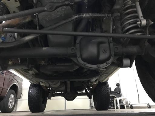

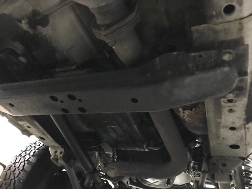

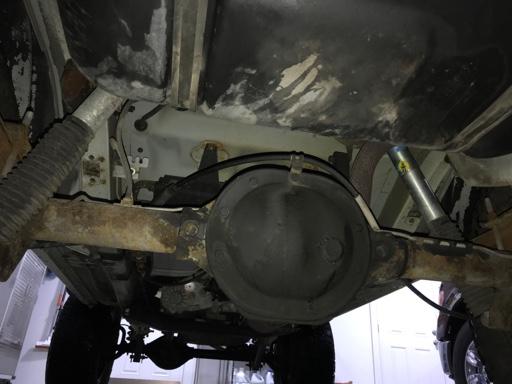

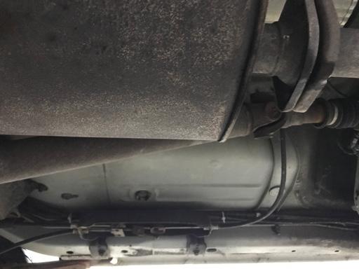

I know what I’m looking for when looking at frames on wranglers for rust but I’m not sure exactly what I should be looking for on the unibody/frame. What are all of your thoughts on the condition of the frame on this XJ? Pics from the owner, haven’t seen it in person yet
That's a lot cleaner than the back east rigs, I've got 2 2000's that you can eat off the bottom (Az rigs).

I would expect the worst on that one but you can tell easy enough.

In the first photo, it looks like the passenger floor has rusted through, in front of the crossmember and to the right of the exhaust pipe.
You should do a deeper examination of the frame to see what else is rotted.
Good catch! I saw that too but had no idea what it was because I’ve never looked under an XJ.
Might put this one on the back burner, 50 mile drive each way may not be worth confirming the floor to be rusted through
