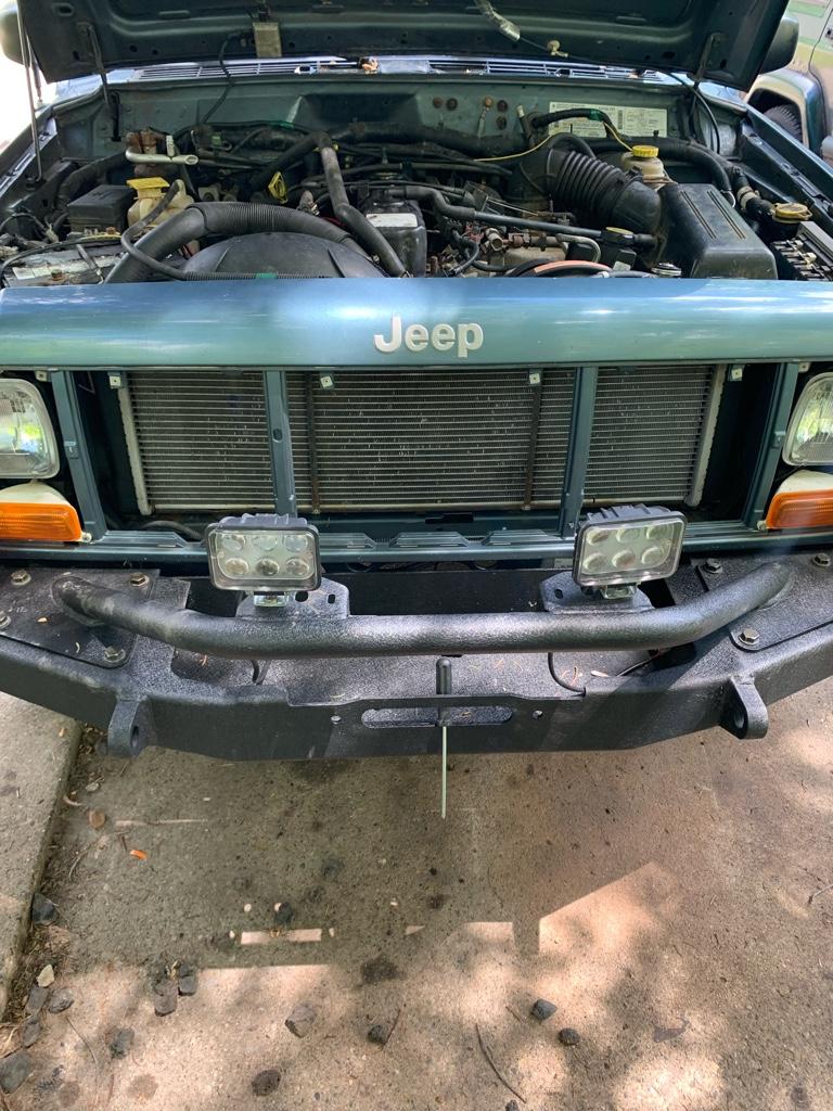

So I was studying diagrams of XJ motors and also my dad has a 00 Sport. We already were aware that the previous owner messed up the vaccum system when he put on the new bumper. I knew he took the AC condenser out....
I didn't realize that there is an entire line that goes to my transmission thats not there until today. Also when we compared both XJs I don't have a trans cooler. When it was below 70 degrees I had zero issues. I also realized they way they did the removal that exhaust fumes or combustion gases were exposed to where air intake would be.
https://www.youtube.com/watch?v=omBcjX8JugE
Am I crazy or is this a hack job?

But realistically if Iím overheating and the car is shutting its self off after driving up to 5 miles. Something is going on where an extra cooler that only costs 30 dollars may help resolve some of this

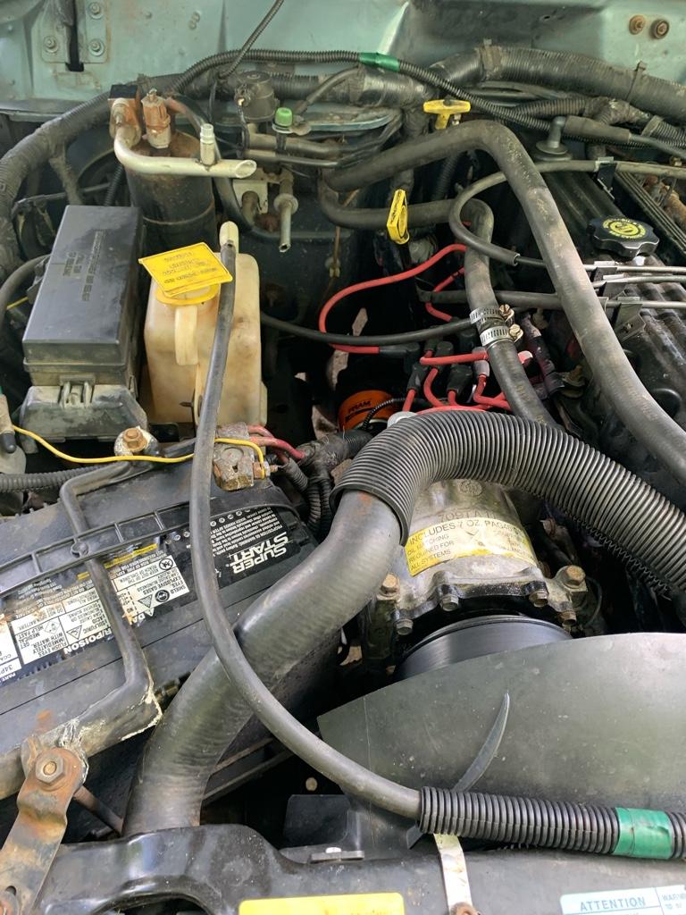

Then we have

Oh My!!!

By the way... Aside from reinstalling that and running the lines. I'm going to just study all the content I can and do the head gasket repair with my dad. Right now I can drive it to and from the gas station about a mile away if need be. I'm going to just take it apart, probably take the water pump back and exchange it for a new one. Probably do a new radiator too. Just to get all of this fixed.

What lines were missing? Did they somehow just loop the trans cooler lines and not go through the radiator at all? No clue what you're talking about with the exhaust. Overheating won't cause a hard shutdown. That sounds more like a failing crank position sensor.

You put CLR in the radiator? Was that before or after the freeze plug started leaking. What the freeze plug brass by chance?
In your rather difficult to watch video(s), I can see the trans cooler line going to the radiator. Not all cherokees came with the extra external trans cooler. Adding a trans cooler is a waste of money. You probably plugged up the radiator with all that stop-leak crap you dumped in there to band-aid a bad head gasket or cracked head (possibly caused by the failed freeze plug not letting the system develop pressure).
*Hopefully you take this as constructive criticism. Your videos are painful to watch. It's obvious you're still learning, but you're trying to present yourself as being knowledgeable. Slow down and make them more than 1-2 minutes, explain the issues. Drop the out of focus flashy headache inducing special effects.

The best way to learnÖ. Is trial and error. I started making my own content with videos in the last few months. I bought a new camera 2 weeks ago with a flip up monitor so i can see myself as i record. Podcasting where no one sees me is so much easier since thereís no i hope i donít look like an idiot.
Iím leaning towards replacing the radiator, I bought a new thermostat i believe i bought the 180 instead of the 195 in the winter. I bought the 195 yesterday, when i first got the Jeep there was brown substance in the cooling system. I donít know if maybe the guy ran a additives and that was what was in there.
The lines for the transcooler are in the engine there plugged up, truthfully the transcooler is 30 dollars. Iíd rather put one back in, exchange the water pump for a new one since itís 3 months old, new thermostat, head gasket and new radiator.
