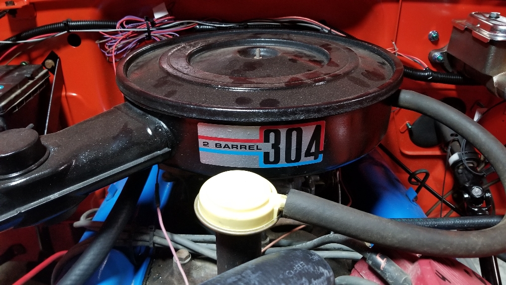

Underhood the wiring is a bit of a mess and the airhorns are going bye bye. Powertrain is AMC 304 V8, T150 3 spd manual, Dana 20 Transfer case, Dana 44 rear axle and Dana 30 front. The transmission needs an overhaul, it won't stay in first gear unless you hold the shifter in place. And the Transfer case has a pretty stout leak from the rear output seal. I'll probably overhaul it as well while I have the transmission out.
