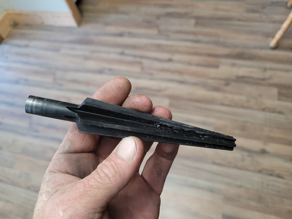

I used 1 ton TRE's and had to ream out the knuckle for the new taper.

I have had my WJ knuckles reamed for the 1-ton Chevy TREs and have used the inserts. Mine is under. The TREs from Ruff Stuff, the boots are still good after say 5 years. Ones I got off of E-Bay, the boots cracked within a year.

Ball joints, hubs, rotor, calipers, 1/4" spacers, knuckles, reamer, steering, track bar, track bar bracket, brackets, time, misc grinding wheels had, welder, someone elses time.
