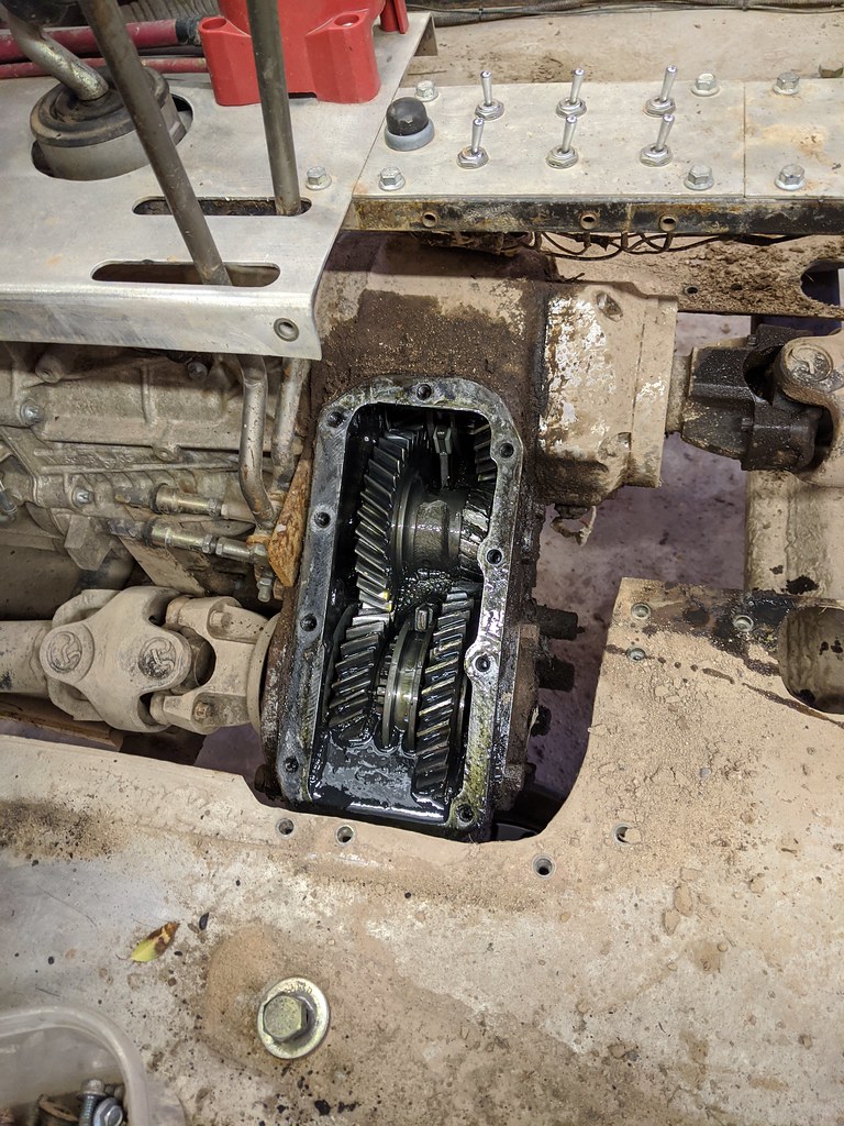

Not surprisingly...about what I expected to find.
This thing looks like it will fit so I gotta swap a bunch of guts back & forth and build some new shifters. Nice little project, I don't mind this kinda stuff.
Considering how long I think you've had that in the buggy (it'soy;246ne you put in when you built it, right, and that came out of something else, if memory serves?), it certainly doesn't owe you anything at this point.[/QUOTE]
Nice. it almost looks to me like maybe you subconsciously planned for this from the start. That the Stak case you told me about?
