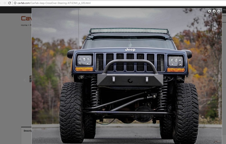

Ok, so the heims, if you're looking at them from the side should (simply) look like an X instead of // ? I think that's the case.
I think both are //
Also, now looking at those photos, I'm wondering if the drag link is bumping my sway bar. And now I'm wondering why my sway bar is sitting so low. I've got the JKS adjustable quick discos, that I thought were properly adjusted..

In that picture, the draglink should be on top of the pitman arm, not below it. Its kind of a shitty design, but right now its installed wrong.
Interesting. On their product page, the install video shows it going on below it: http://cavfab.com/CavFab-Jeep-CrossO...JMJ_p_105.html
I'm open to information. Why do you think it should be above?

Look again. Look at the relationship between your RE trackbar mount and draglink, and then look at theirs. Their draglink sits a lot higher than yours.
You want your trackbar and draglink to be parallel (pivot to pivot, so you need to draw a line on the picture between pivot points to really see it).
Your geometry is way off.
