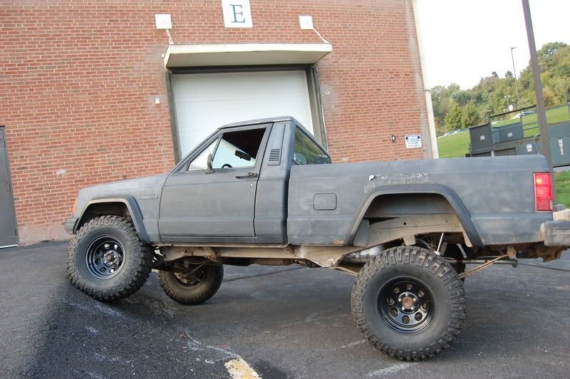

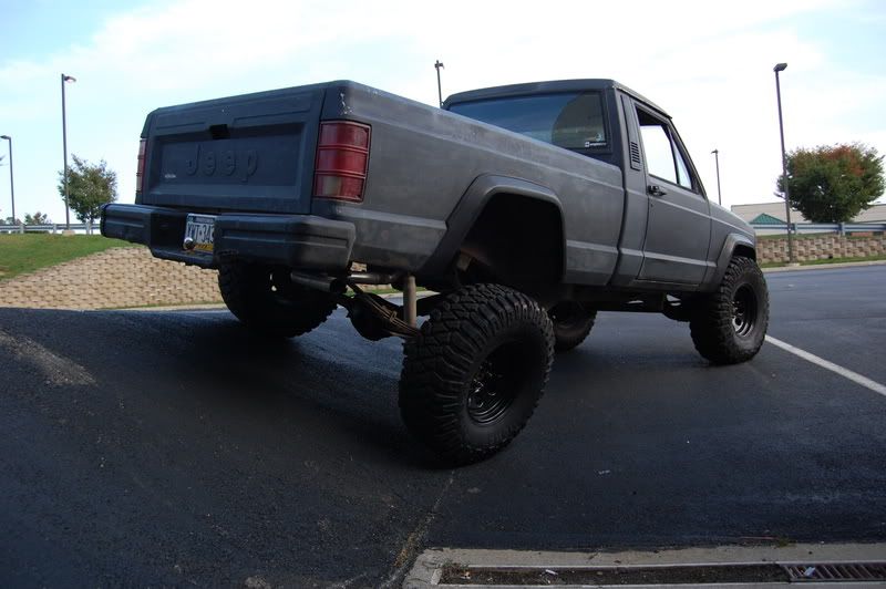

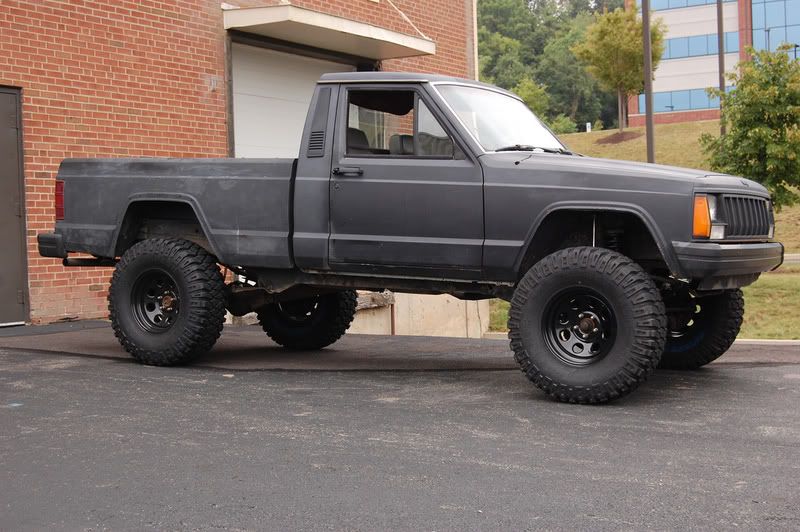

I purchased my MJ in June of 08, it was bone stock.
4.0l 6cyl 2wd auto.

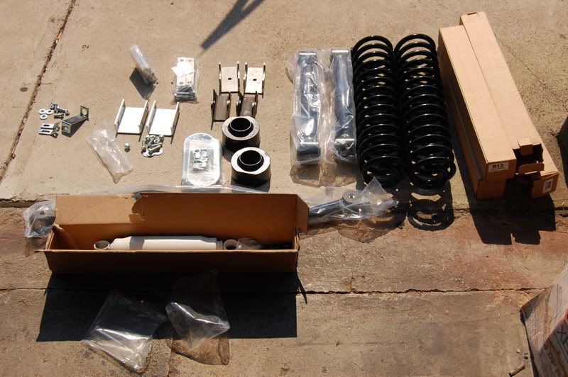

bought a 4.5" lift from rustys (i know they suck)
and some 33x12.5 tires on cragars
replaced the ICM
had to put a new gas tank in
then finally got it lifted (yes, it has alot of rake)
recent updates include new fender flares, vent covers and mirrors. next on my list is a new rear bumper. then i have to take care of the rust, and get her painted.
after all that i will finally start on the 4wd...
let me know what you think.

well done, love the street side garage too... just be careful of someone spending too much time looking at your ride instead of the road.

The beast could use some paint but it looks pretty nice the way it is, too.
Any plans to go to 97+ or Beijing front clip?
Regardless... nice ride and welcome to Naxja. Keep us updated w/ pics!

im slightly displeased with the kit i got. the front springs provided dont match the amount of lift gained in the rear by doing SOA. and the sway bar drop brackets are just plain silly. ill be getting rid of them very soon. but so far strength wise its holding up very well.

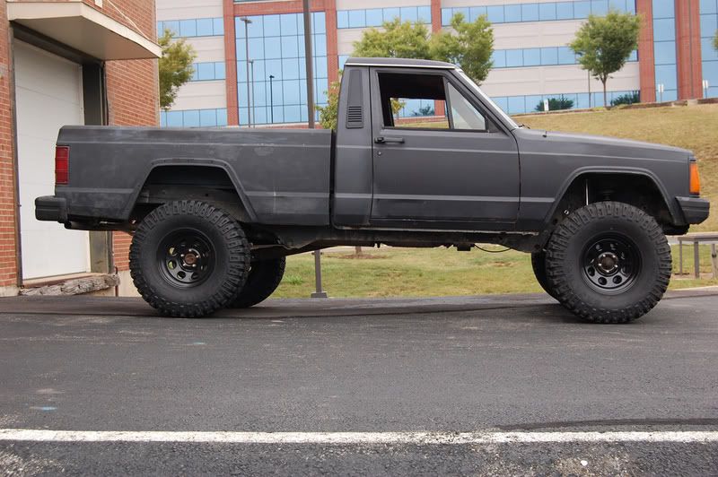

Generally MJs, and most trucks, have a rake so they maintain proper steering and suspension geometry when carrying a load. Looking at the first pic, it already had the rake
I think it looks good as it sits, and the rake will actually help with your departure angle.

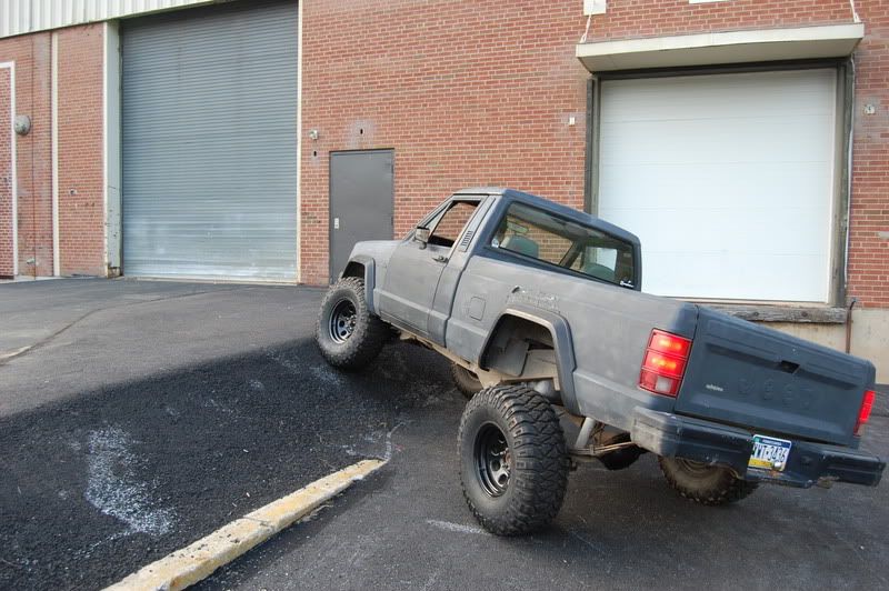

did some rear flexin.
birthday coming up. getting a back bumper, some hot rod flatz black paint, and some new adjustable lca's and uca's so i can plop my 1.75" spacers in up front. then she'll sit level, AND the wheel will be centered. after that the hunt for a 4wd donor begins.
