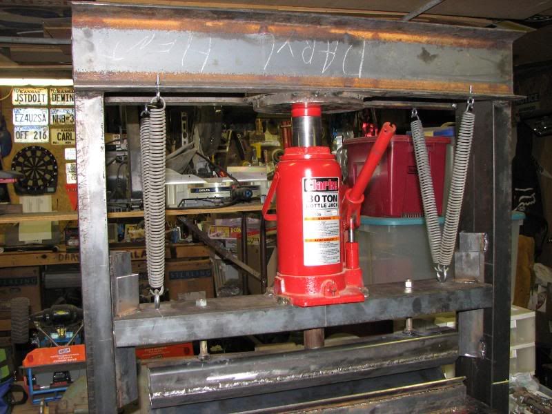

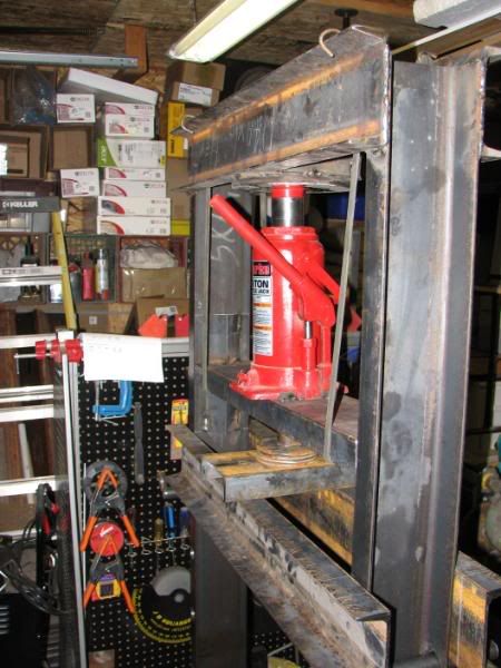

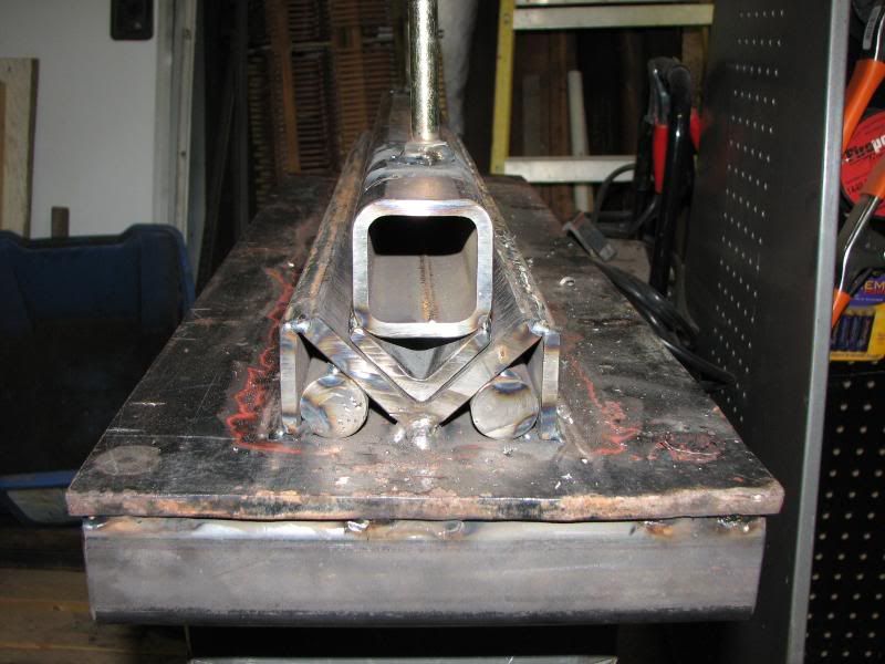

To install new bearings in a 9 inch, one needs a press.....
So.... I am making my own.... Was doing fine, until I ran out of wire....

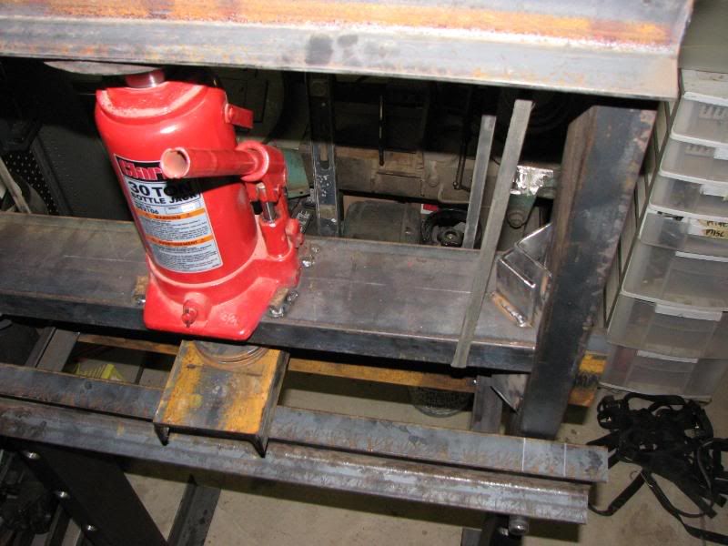

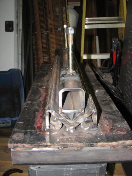

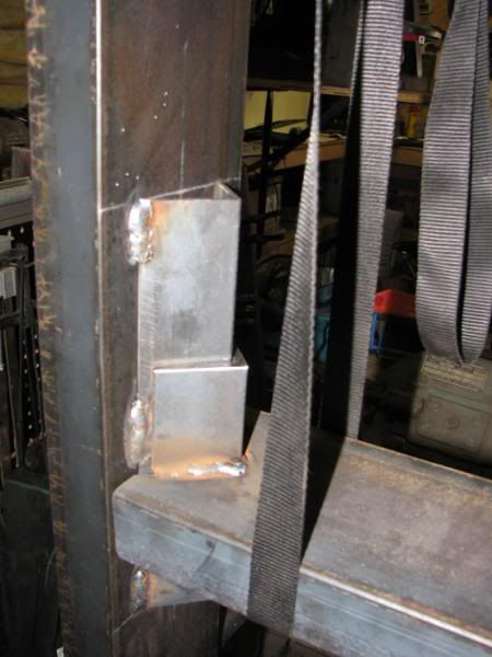

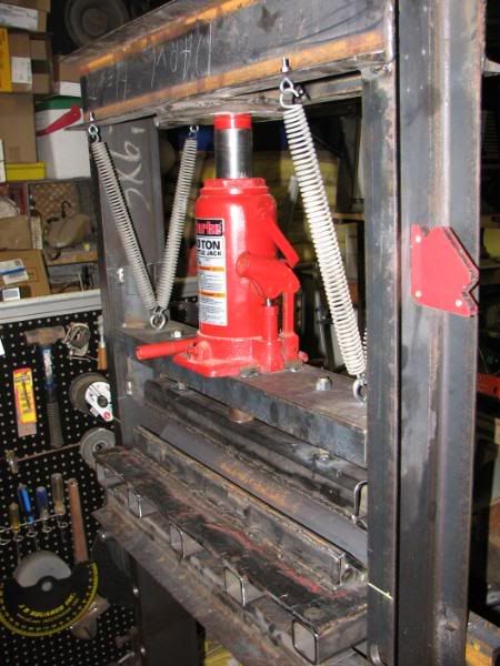

Got some more wire, and some more done. I need to replace the rubber straps with some springs... Maybe add some paint.

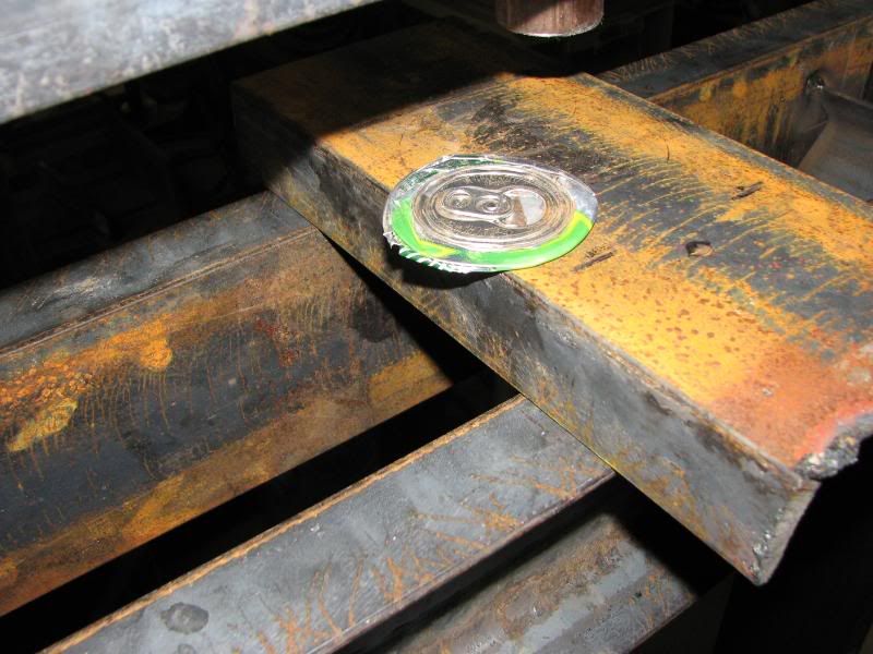

This is how I decided to keep things lined up....
It works...
On aluminum cans any way.....
Down to about 1/8th of an inch.
  #6

28' of 5" channel
4' of 3"x1/4" angle
4' of 2"x1/4" angle
1' of 2"x1/8" angle
1 8"x3/4" circle
2' of 1" solid rod
3" of 1 1/2"od 3/4"id tube
Give or take......

That's a lot of weight (we bill by the pound), with the cost of steel it kind of makes a H-F unit enticing. What size wire did you use?
  #9
Old May 5th, 2008, 21:36
JEONLYEP's Avatar
JEONLYEP JEONLYEP is offline
Join Date: Jun 2003
Location: N 37° 48.485 W 100° 20.903
Posts: 1,517
Re: To install new bearings in a 9 inch, one needs a press.....
This is getting riDICKulous.....
Wait, that doesn't work......
.035
I'd bet the HF unit gives before mine.....
Plus I got the fun of designing and building mine.....
Plus Plus, no HF for over 150 miles.....
Plus Plus Plus, I got the fun of designing and building mine.... Did I say that already?

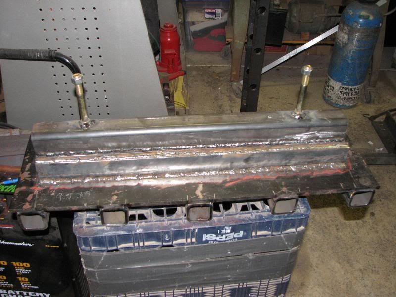

66% done with the plate break that goes along with this press.
But I was tired, so I just came inside without taking photos....

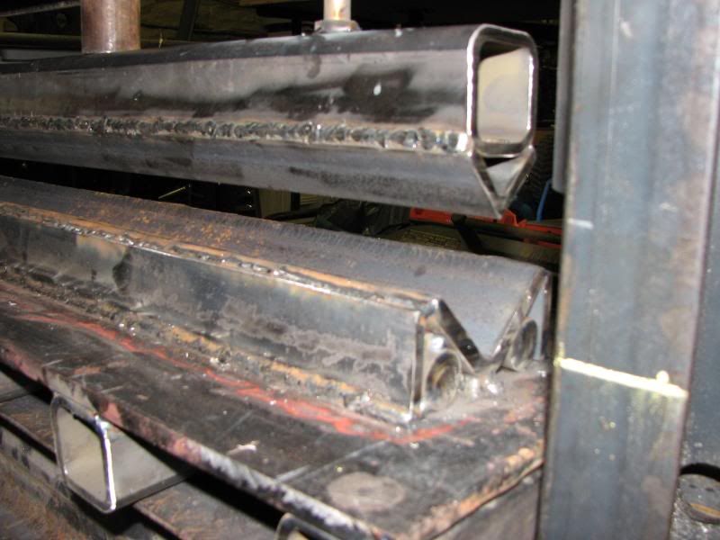

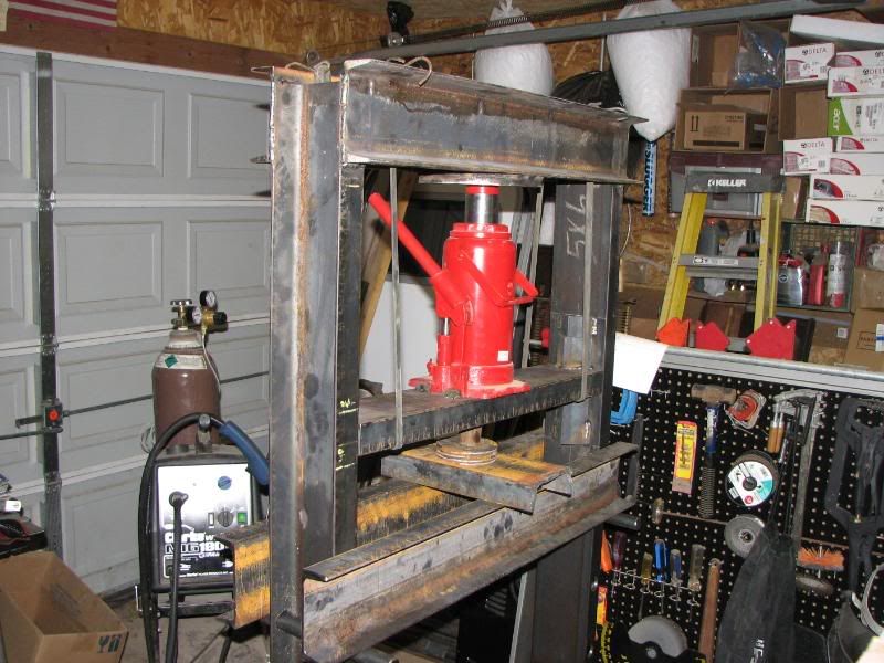

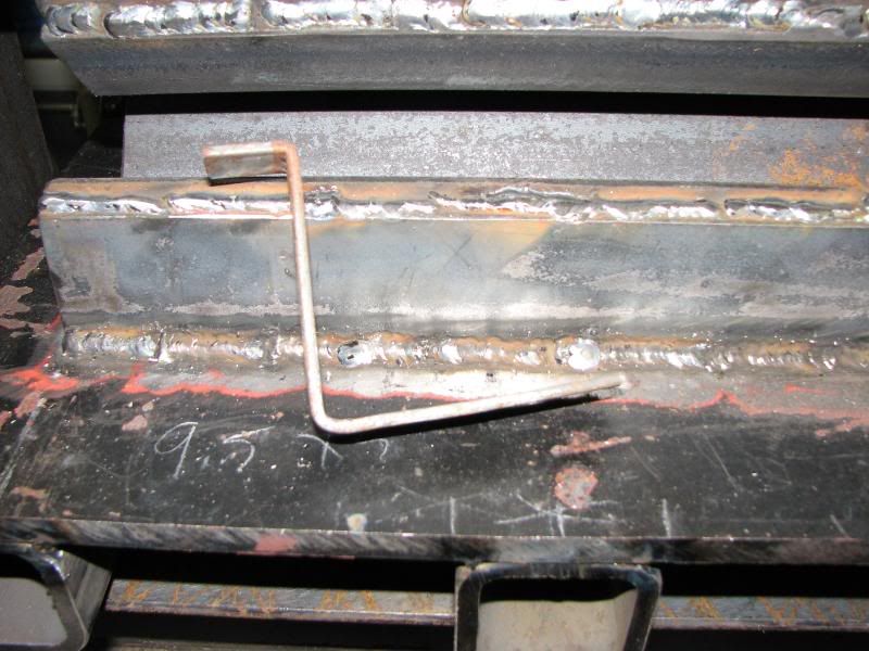

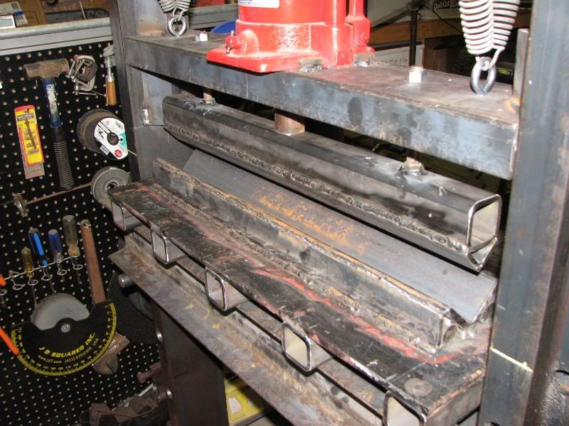

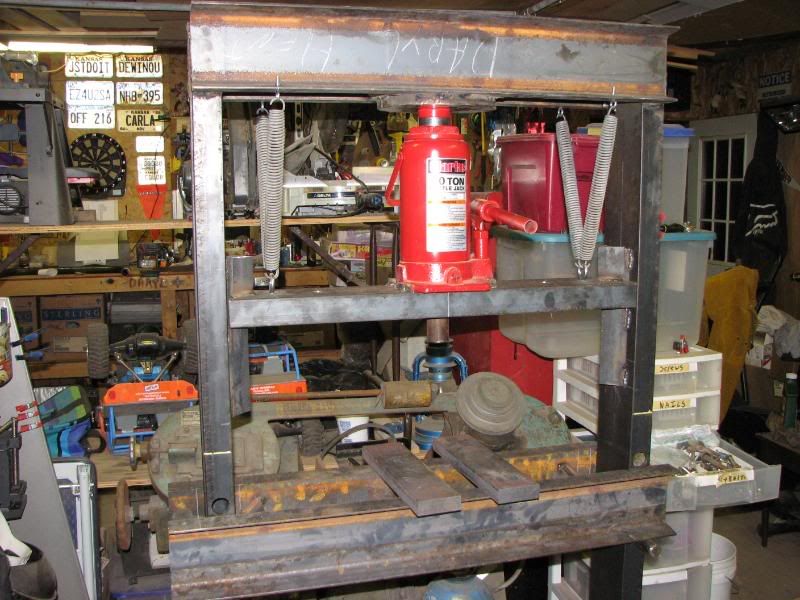

I hate to BREAK it to you guys....
But I had more PRESSing reasons to build this...
But on to the finished photos.....
With springs...
And with it's new break in place...

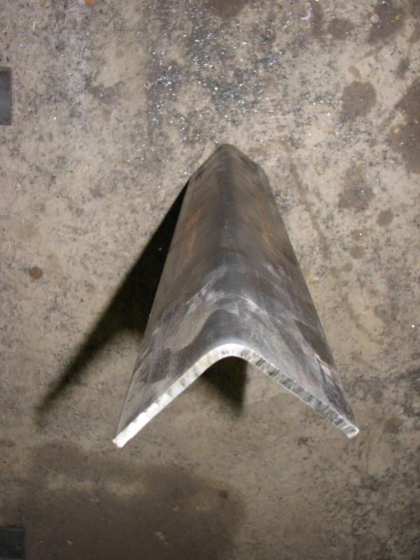

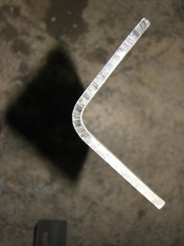

Break by it's self...
1/8" x 1" Bent... The bend with the short leg wasn't made by this break...
3/18th" x 24" Bent...
Video of break in use...

Dude you have got to get yer arse over to Harbor Frieght and pick up an Air Over Hydraulic Cylinder. You arms are gonna fall off.
