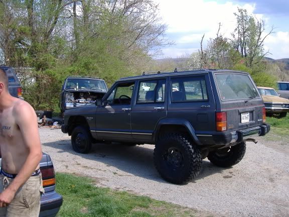

Yeah the center caps screw on from the back, you just have to drill holes in your wheels.. I bought some countersunk screws so they clear the drive flanges fine...
I paid $6200 in Idaho for it. Had about 62k on the clock when i got it... that was about $1200 below book around here...

my xj had the same life before i got my hands on it.
i payed 6000 in 2003 and it was booking at about 9000.
that sidewall seems to have a pretty aggressive profile... ..are those really just bfg ats?

High Tec Retreads OTR Muds, 31" flavor
http://high-tec-retreading.com//desktopdefault.aspx
