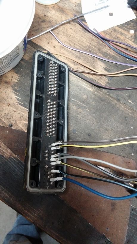

[QUOTE=Cummins90;246417065]
This is the ecm connector cleaned up.
Nothing too complicated just meticulous.
The extension harness wasn't too hard to make with a spare had ecm. No connection issues as of yet. I had thought of taping off the ecm side and pouring a soft potting material into the wires to set them in place.
