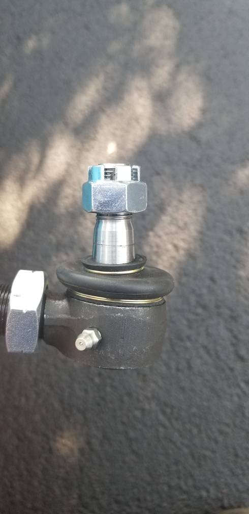

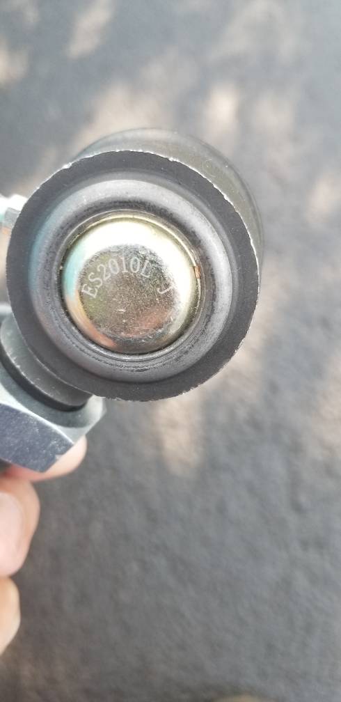

Here's the TR.
EW2010L J.
Left (J) our, don't know if that makes a difference.

Probably a chinese joint, the good american tre's ones are 5/8-18.

Yeah that is not a MOOG joint. The hardware is all wrong.

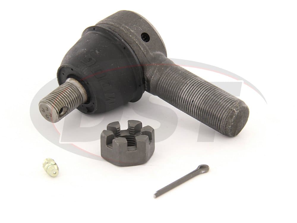

This is what a Moog ES2010 looks like.
To the best of my knowledge, Stinkyfab is the only vendor providing actual Moog joints.

Looking at every "ES2010L" on rockauto, that appears to be an Ultra Power brand.
The cheapest they have. It sells for $5.
