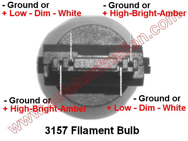

Parking lamps are separate filament. Check them and you can verify power and ground at the bulb and work your way back.
There are two sections of one bulb that light?
I just popped the top one out and realized it's only one bulb lol. That makes sense now, I was puzzled.
Alright so I have power to the pink/blue trace and white wire on the switch. The same white wire from the switch that's running to the back,Power is constant here until the 12v disconnects when the switch is pressed.
I assume the brown wire to the tail light is supposed to be a secondary supply for voltage once the brake pedal is depressed Illuminating the other filament?

It was the bulbs, but I found two things I'm glad this led me to fix. Yellow tank wire starting to get cut, and the tow wiring had a black square portion that was rather warm. It got gutted out. Now I just gotta figure out this bit I've found under the steering wheel lol.
