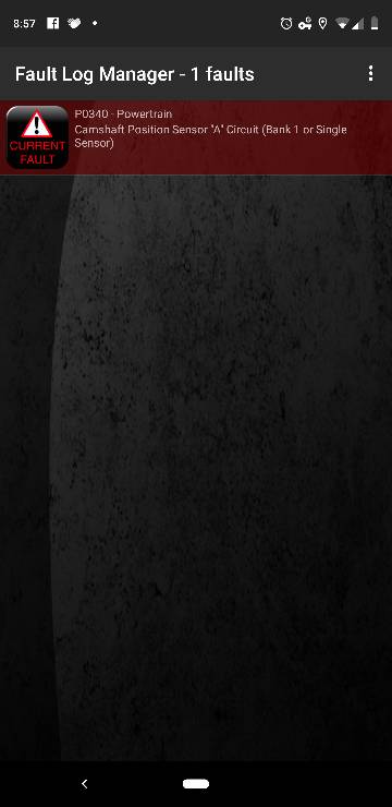

XJ Wrong PCM replacement? No spark
Okay so I cleaned all the grounds and checked fuel pressure at the rail and it is about 45 PSI. I did also get a Bluetooth OBD2 and installed torque. I get the two error codes in the photo. I see one may be the TPS sensor so I cleaned it's ground with no luck. Maybe the sensor? I am not sure what the other code means but I still don't have spark. Not sure if it is the rail or something before the ignition rail.

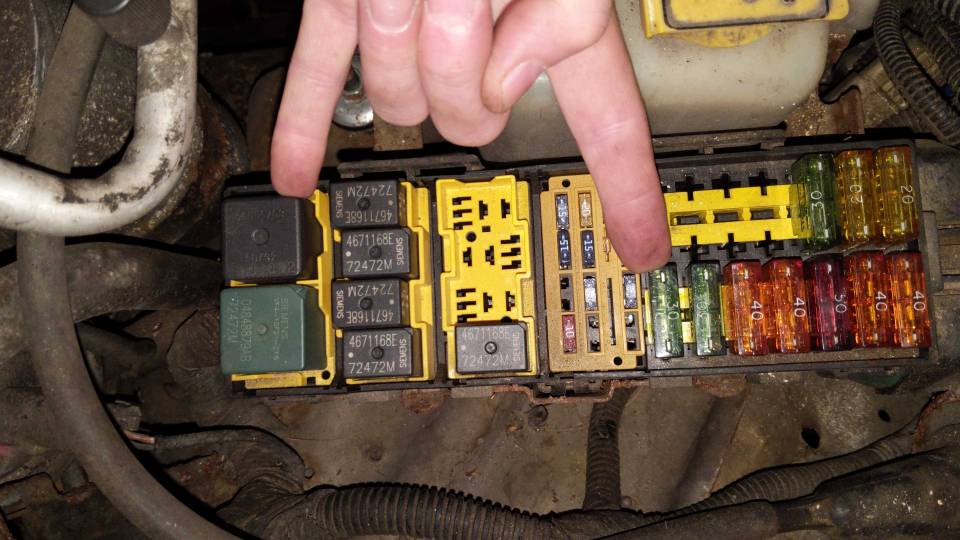

Re: XJ Wrong PCM replacement? No spark
Is there a relay in place in the PDC for the ASD position?
Yes on both the ASD and ASD relay fuse
Use the OBD-II trouble codes to guide your diagnostics and sensor testing.
A simple Google search discovers this:
P0122 JEEP - Throttle Position Sensor/Accelerator Position Pedal Circuit Low Input
Possible causes
•Faulty throttle position sensor
•Throttle position sensor harness is open or shorted
•Throttle position sensor circuit poor electrical connection
•Faulty Powertrain Control Module (PCM)
P1694 JEEP - No Messages Received From The Powertrain Control Module
Possible causes
•CCD Bus (-) circuit open between Powertrain Control Module (PCM) and Transmission Control Module (TCM)
•CCD Bus (+) circuit open between PCM and TCM
•Transmission CCD bus wiring damaged
•Faulty TCM
I feel like I am chasing my tail here.....or maybe making headway. Not sure. I have been able to get rid of the last two fault code by replacing a couple of parts thanks to everyone's help. However now I have a new code. Not sure if fixing the last codes allows the computer to see a new faulty sensor or not. I have a replacement camshaft position sensor on the way as that is the new error code. Could this be because the Jeep was sitting for two years or am I just chasing my tail here?
I agree that probing for 5 volts at all the OBD sensor is a good starting point. Physically look for wire harness damage and wire plug damage and consider that there may be one or more faulty wire splices.
P0340 JEEP - Camshaft Position Sensor
P0340 Jeep Possible Causes:
•Faulty Camshaft Position Sensor
•Camshaft Position Sensor wire harness is open or shorted
•Camshaft Position Sensor wire plug poor electrical connection
•Faulty starter motor
•Starting system circuit
•Dead (Weak) battery
P0340 Jeep Tech Notes:
Sometimes and in some models, low battery voltage or a weak starter can trigger a Camshaft Position Sensor code.

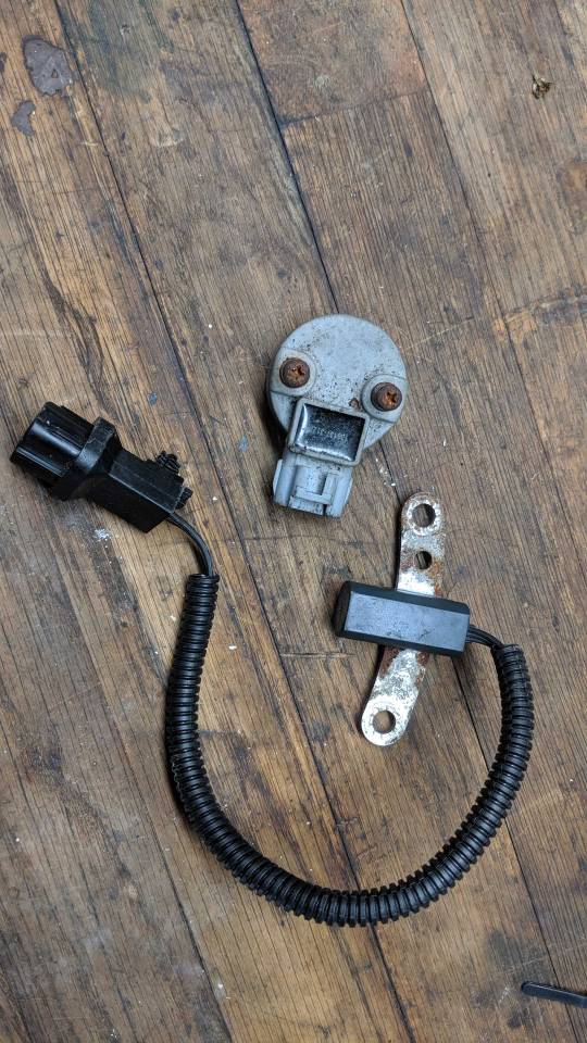

Okay so my Bluetooth obd2 died on me but I have a new one now. I changed both the cam shaft and crank shaft sensors and I am still getting the P0340 error. I am getting my self a bit confused though. Which sensor should I be looking for 5volts on?
All of the OBD-II engine control sensors are 5 volts.
