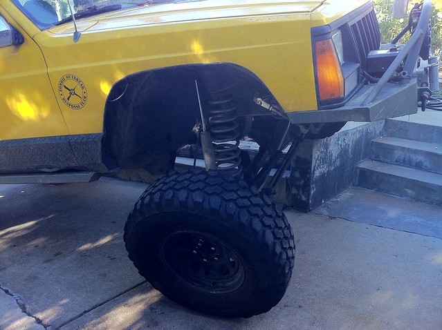

What do you think? I know I'm kinda cheating with the jack but I just finally finished the front and wanted to post a picture. My build thread is on JF but i think their server is down or something. This jeep is lifted 2" in the front and 2.5" in the rear. I've been working on it since November one thing at a time. It was completely stock in November.
Those shocks look awfully long and I dont see any additional bumpstops.
have you bumpstopped it?
i run 31's on my 2"/2.5" spacer/AAL bb right now and it rubs pretty good over bumps

its nothing impressive. but most flex doesn't mean you have the most capable jeep out there. if you want more flex you need to find out what limits it and address that, be it shock length, brakeline length (hope not) control arms binding/hitting, trackbar, or whatever.
What exactly are you asking? You don't have much of a choice for additional down travel unless you change your control arms. Looks good-to-go for me.
I don't know much about the new OME shocks, but here is mine at 2" with 30" tires and factory LCA's. Looks about the same.
looks good to go to me.
Want more drop. Do the grinding like listed above.
You got the right idea. Flex her out and craw under there. CHECK everything. You don't want any stearing part, brake line or shock to be your travel limiter. But many do use there shocks to limit travel with few problem. I say strap it soon.

This is how much drop I get with short arms. I acheived this with shock length, break line length, clearancing the AE LCA mount, and lengthened drive line. (I didn't actualy lengthen the drive line, I installed a shorter yoke at the t-case.)

when getting that much droop with shortarms keep an eye on your driveshaft length. thye can be completely compressed when the axle gets pulled back that far

On the driveline length-I miss wrote-It should have been "SHORTEN the driveline", but I installed a shorter yoke at the t-case.
Also with the shorter yoke, I had to clearance the crossmember for the driveline.

I agree, OP's droop is nothing special. Bumpstop and long travel shocks will get you more droop. I could drop the tire below the rocker panel with short arms, but at that point, you usually don't have any weight on that tire, so you better have a locker.
If you are running stock arms you will need to make notch the mounts to get more drop.
Also make sure you brake lines are long enough, I still need to install my longer ones.
