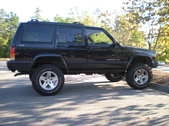

Fortunately, in that pic, the rear leaves have not been installed yet (hence the *major* height difference).

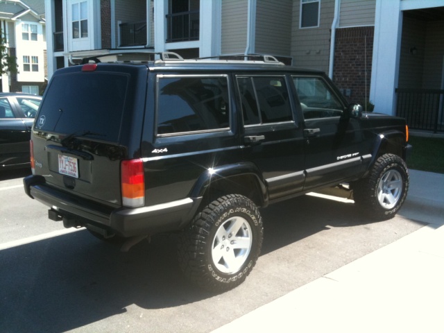

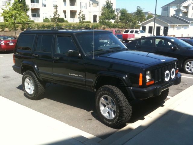

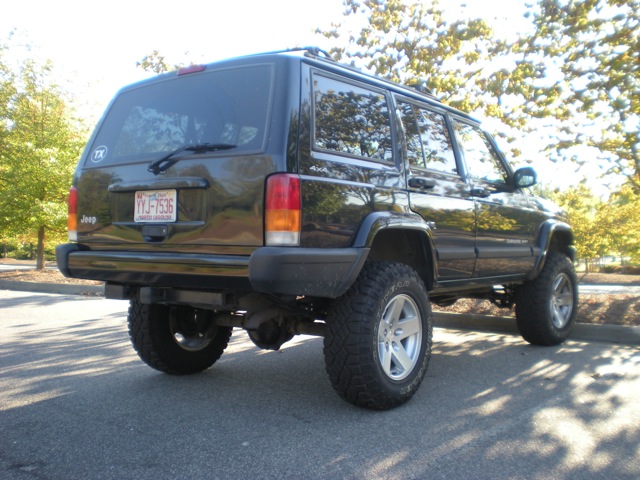

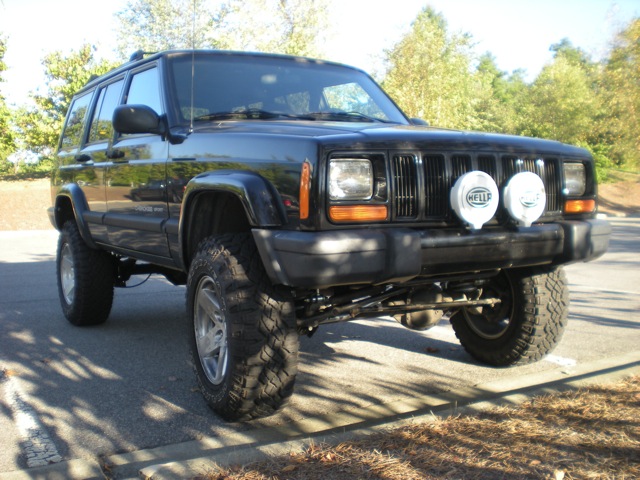

Well, the lift is finally installed (finished a few days ago but went back home to San Antonio for a 4-day weekend)... Pics!
(click for larger images)
I'm definitely loving it, however, I have a few issues:
  • These springs are STIFF. The valving on the 5100s is able to keep it under control, but at this point I'm reluctant to drink from an open container while driving on many of the highways around here... Dips in the highway are very pronounced with these springs, and have already led to a bit of coffee in my crotch.
  • The lift sits higher than 3.5" (much higher), but I'm hoping some of that will go away... The rear really irks me, as I get some pretty bad driveline vibrations between 15 and 35 mph. Looks like a HD SYE and drive shaft are coming next (going with Tom Woods and Advance Adapters). I'd like to get the 242 in there, but given the complications that might arise with the SYE I'll be holding off on installing it until later in the project (it'll go in with the HP30 and all corresponding axle upgrades).
For those who own the Rubicon Express 3.5" lift (coils and full leaf packs) - does the ride soften at all over time? I know I can expect the rear to sag a bit, but at this point I feel like I'm driving a leaf-sprung lightweight F350.

Looks good, but definitely taller than 3.5". Are you planning on running taller tires eventually?
  #26
Old September 15th, 2010, 08:30
anthrax323 anthrax323 is offline
Join Date: Feb 2009
Location: San Antonio, TX
Posts: 1,232
Re: Time for a build thread... 2001 XJ
Yeah, without a doubt. I was hoping that the RE 3.5" lift would be a true 3.5", but unfortunately (as I was warned over and over and over), it is not... Thus, my 30x9.5's look a little small.
The largest tire I want to run is 31x10.5. Only marginally larger, but they'd fill out those gaping wheel wells considerably better and most likely avoid any rubbing.

Originally Posted by austinaubinoe View Post
dang the front looks high! might want to had a shackle to the rear, the coils dont settle that much.
ive found the opposite... even after towing many times (21ft chris craft... 4k lb boat, trailer tongue weight is somewhere around 800lbs.) my rear still sits higher than the front.
4.5" super flex kit. with 31s. i think itll be more of the look you want when you go to 31s. i trimmed my fenders and now 31s look small.
