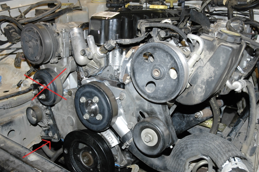

Ignore the red marks, from something else. This is a 96. The belt tension adjuster is the pulley below the power steering pump pulley.
Are you saying you don't have one?
The belt goes over the PS pump, under the water pump (smooth side of the belt against the pulley) and then up and over the AC compressor, down and around the fan (again, smooth side of belt to pulley,) then around the alternator, down to the crank, up around the tensioner pulley and over the PS pump.
