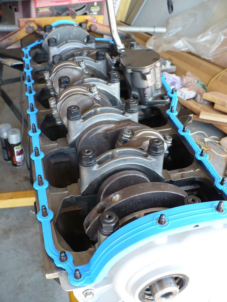

If you buy Felpro kits they come with plastic aligner/holder pins. Or you could go all the way like I do and stud the pan, it makes the install simple easy!
I did it on a stock height Jeep by removing wheels supporting at the unibody allowing the axle to droop as much as possible (didn't disconnect anything else) then removed the starter and one of the large corner bolts/nuts on the flexplate cover on the same side as the starter and got it out easy enough.
The felpro kit with the little plastic screw in studs made the job a million times easier than normal and it's a damn good gasket so I highly recommend that route for a replacement.
I learned the hard way that if you stud the pan, you can't pull the timing cover without pulling the pan first. Now I put bolts in the 4 holes that go into the timing cover.
My pan was held with bolts, no studs. It came on and off fine, the Felpro installation studs sure worked well too. Besure to wrap the exhaust and any other things the pan may bump during install, I used thin card board around the exhaust, and plastic bags around some wires that had lots of dirt, or flaky rust on them so that no grit would be dislodged into the pan as I maneuvered the pan into place. Wiping these parts clean was not enough, so wrapping them worked out well.
