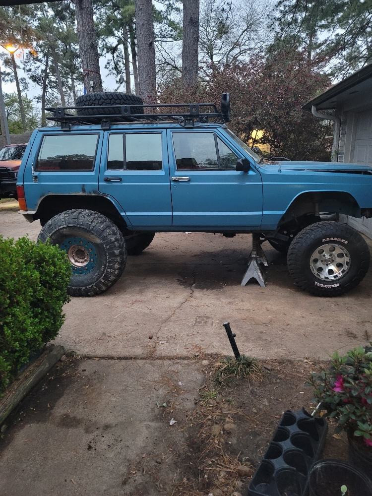

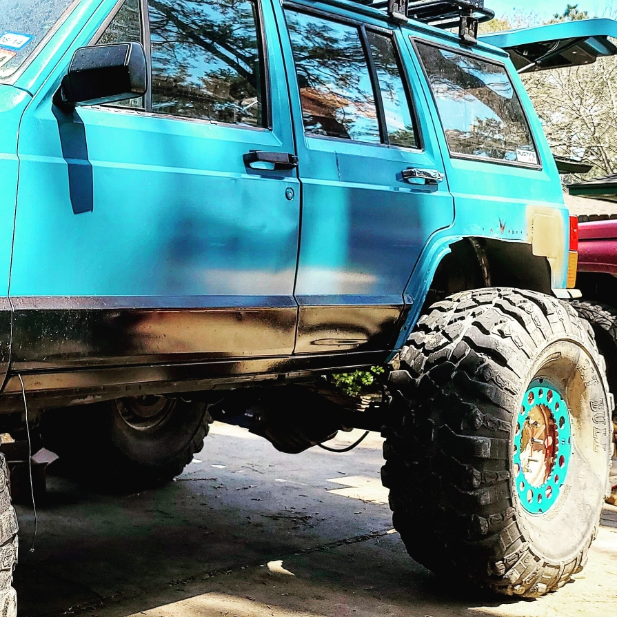

My build of my wife's daily driven 94 xj crawler trying to do a build thread
Well I'm new to naxja and trying to do a build thread also uploading videos of the build on my YouTube channel for those who would like to see my pain and suffering
94 xj
King pin d60 front 5.38s Detroit
Gm14bolt rear 5.38s spool
14inch travel fox coilovers front
Rear leaf spring flip netted 6inches not 4 with shackle relocators
Rustys longs arms and coil over hoops
Cheap trac bar
Nv3550 from a tj
Rocktrac rubi case from jk

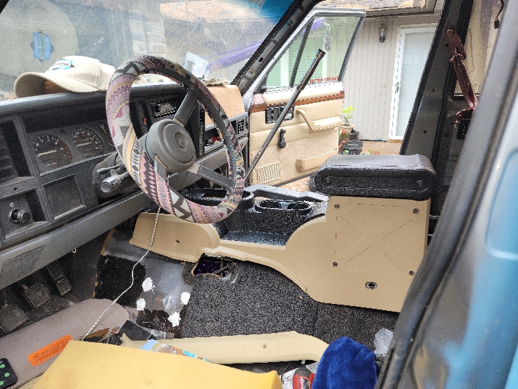

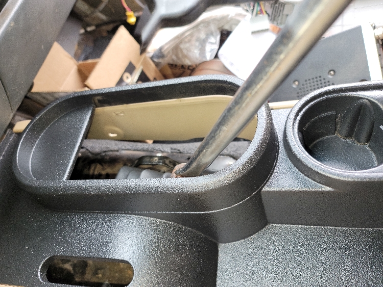

Center consol from a jk
Hacked together artic truss from an old axle
Hutchinson beadlocks with 40 13.50 17 maxxis razors
Psc hydro assist axle stretch goal is 110 to 111 we shall see
Will be on my YouTube @ whiskeycustoms
Sent from my SM-N986U1 using Tapatalk
Cool swap with the JK center console. Haven’t seen that before.
