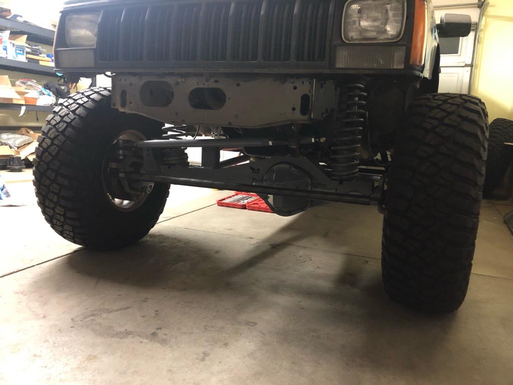

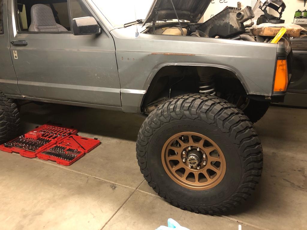

I don’t have a lot of photos of my Jeep as when I take it out, I usually forget to take any photos. I’ll try to attach some if I can figure it out.
