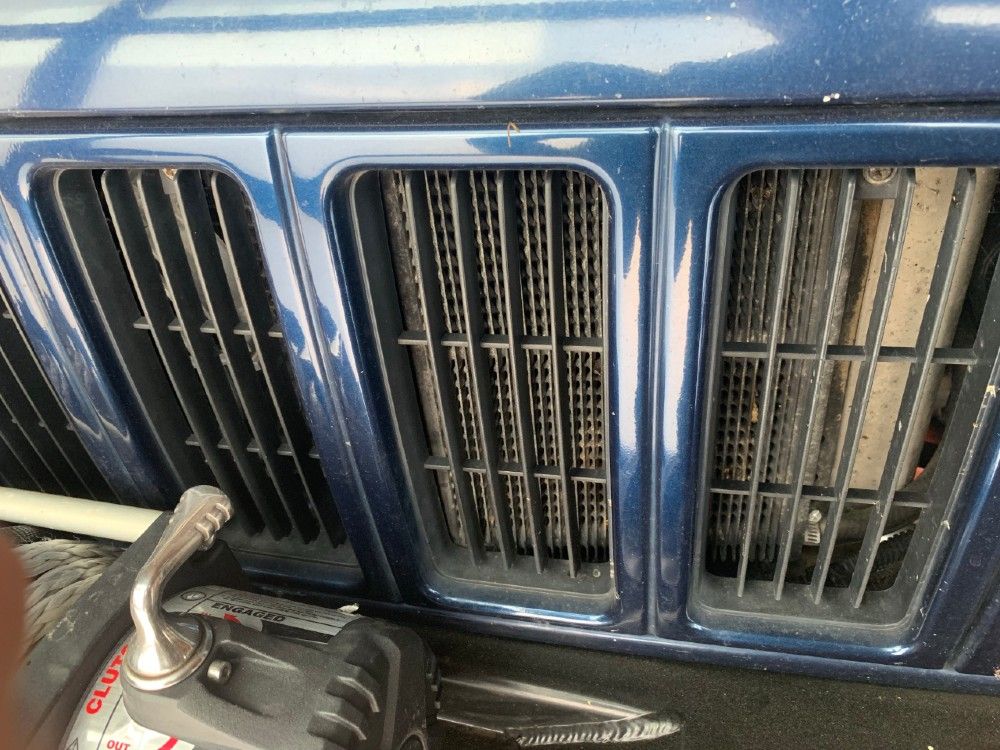

In my rig I bypassed the cooler in the radiator, and am running two separate tranny coolers (overkill!) . I have a heavy girl on 37's, steel bumpers and a hybrid cage. The tranny use to heat up on the long climbs in the mountains. Separating the engine cooling from the tranny cooling allowed me to isolate each system and deal with them separately. Now both systems run really well -
Really dig your rig, do you ever plan to use a radiatoir that uses it's surface area for coolant only? 4.0 powered?

I replaced the lower rad trans line, it's the only reason I was thanking of keeping quick connects. Did you ever run extra cooling rads?

I did run an external cooler. I bypassed the rad, helped with the engine temps slightly but was a bigger help for the tranny temps. As for the temp the AW4 likes running a little hot, think it's 170 or 180 as the ideally operating temps. Really the biggest issue someone will ever say they had would be in the winter if you are dealing with sub 0 temps.
