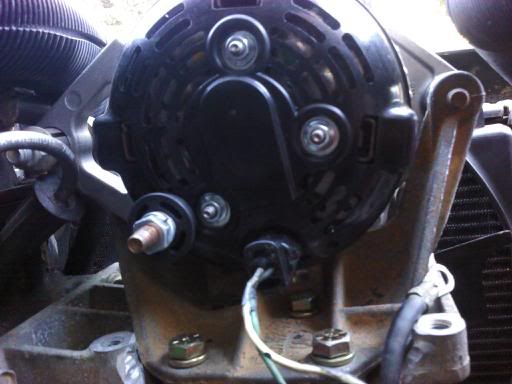

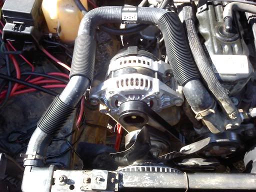

After that everything should bolt up pretty easily and fit like this.

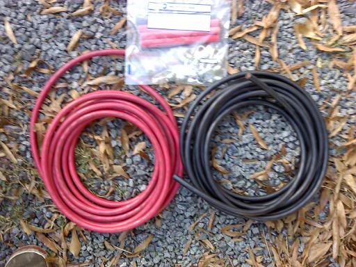

Now you must upgrade the main cables in your jeep with the alternator upgrade. There are plenty of write ups on this I will just post a few pics.
The new cables and materials.

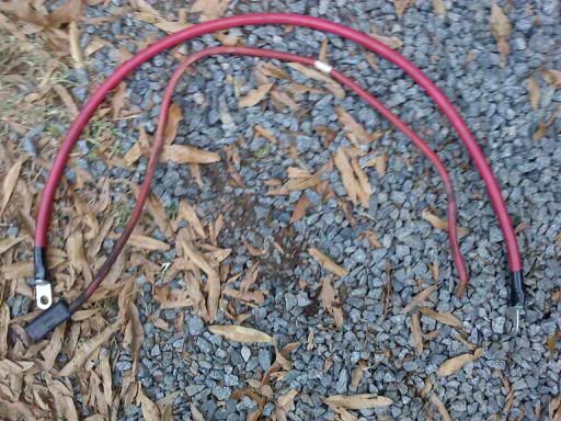

A comparison from the new cable to the existing cables.

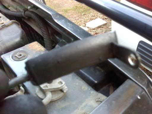

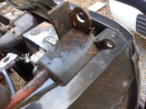

This was a lil odd. This is my starter cable.
I had to cut part of it off because part of it still has to be used. This is the part to keep by the way.

I can absolutely give you more pics of the finished product. I will get the heat shrink on there I was just in a bind trying to get it done, and have yet had the time to get back at it.
Was there anything in particular you would like to see in the pics?
