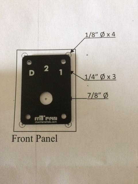

I decided to mount the controller on the dash very close to the location shown in the pics on their web site. I moved mine lower because I intend to have a GPS mounted above that area later on. I put it about 1/16" above the bottom edge of the of the panel next to the instrument cluster.
Here's their mount:
Here's mine:
First problem: while preparing to drill the dash, I noticed the supplied template was a little off. Might be a printing or scaling error. It would probably have worked anyway, but I market the holes using the switch mounting plate with a sharpie. Center drilled all the holes 1/16", checked against the faceplate, then drilled everything out with a Unibit.

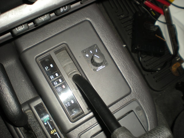

My cosmetic change: I'm using small countersunk oval head screws to mount the switch plate instead of the supplied pop rivets. The 2 screws in the pic are temporary. I don't like the stainless finish, and I'm going to paint the faceplate grey to match the dash.
From the driver's seat, it's hidden by the steering wheel:
This pic didn't come out(best I could manage) The green light just right of center is the controller with the dash lights on. As you can see, it's brighter then the dash lights, although at the lower end of the scale on the dimmer, it's about the same. It doesn't show in this pic, but it's also morre of a green/yellow instead of green/blue like the dash lights. I',going to try putting a piece of green plastic under the face-plate to make it match better.

I failed to mention in the writeup post: The wiring harness that comes with the controller is long enough to mount it just about anywhere on the dash in front of the driver, and anywhere on the console back down to the last cup holder. It might be a little short to get it up on the arm rest(didn't check that)
My impressions so far are that it's good for a daily driver, dual use rig, or trail rig. It might be a little fiddly for a rock rig or a full on race truck. Anything but a positive detente shifter would be hard to use when your getting thrown around like that.
