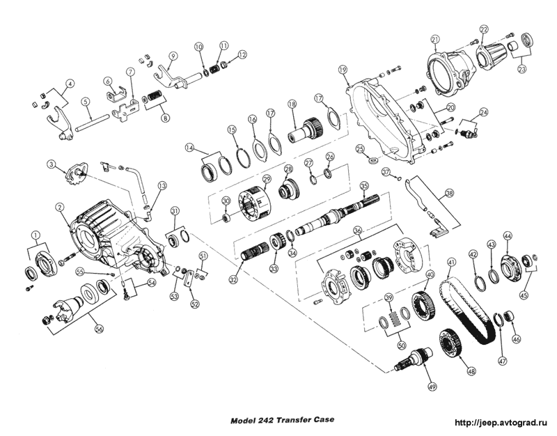

NP242 fill and drain plugs (outside view)
NP242 (inside view)

I'm curious now... is it on the front half of the case? 54 in this picture?

I think he's talking about #20 in that picture, but not sure...

# 54 is the brass plug - has to do with the shifting mechanism.

#54 should be the sift detent ball, spring & plug. If it is leaking you can back it out a turn or two, clean it up with brake cleaner, squirt a little silicone sealer in between the head & the case & tighten it up. Should stop the leak.
