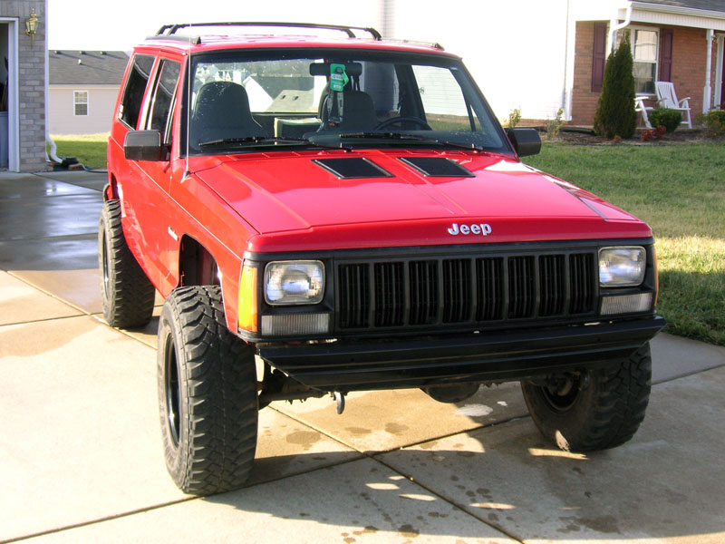

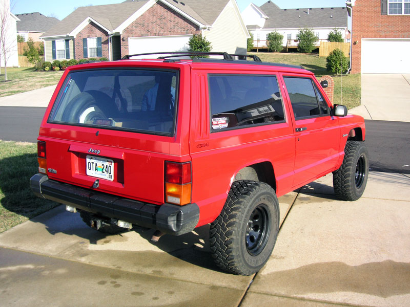

Here is the 99 with the 31's on it, complete with saggy springs...........
Heres a pic of it with the 30,s ......
