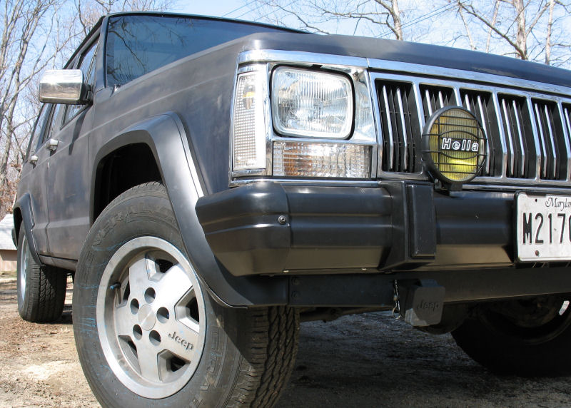

Here's a poor pic of the fenders, hood, and grille reattached and all aligned. I knicked up one of the fenders putting the hood on, so it looks like I will get to test my easy-to-repair theory pretty soon. Actually I am considering another surface coat after the first pass at wetsanding, just to make sure everything comes out the same color.
This is kind of dorky but it makes me happy. Part of reassembling the front end meant fixing things that were broken. I bought a mechanical fan shroud from a part-out, and also painted the radiator and grille header panels.
