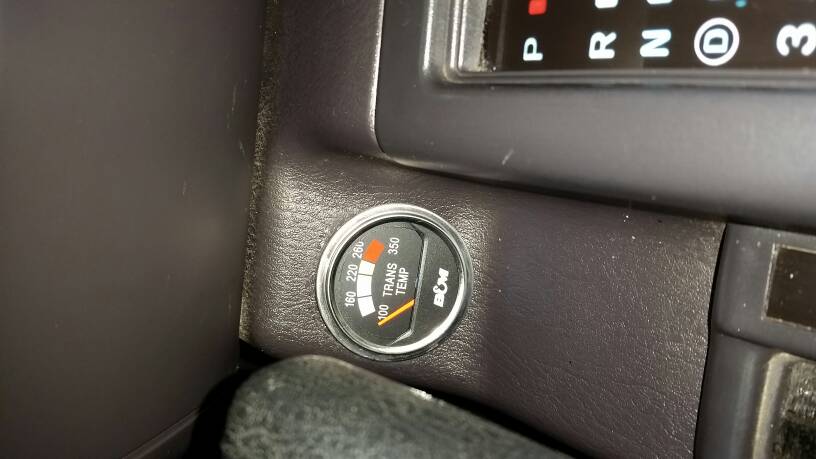

Hello everyone,
I just installed my lovely temp gauge.
It'd all wired up, but I'm not getting a valid reading. The gauge illumination works, but the needle stays below 100 F.
Either my temps aren't reaching (I doubt it, even though it's 10 F here in Ohio) or the wiring isn't done correctly.
I've wired the "GND" post on the gauge to battery negative terminal.
I've wired the "-" post on the gauge to the sender, which is installed in line with the cooler OUT kine just before it enters into the tranny cooler side of the radiator.
I've wired the "+" post on the gauge to the pnk/bwn wire on the rear windshield wiper motor so that it is ignition switched.
The gauge illumination is also wired to this same pnk/bwn wire so that it illuminates when ever I turn on my ignition.
I've driven it now a pretty long distance just to ensure transmission is up to operating temp, yet the needle hasn't moved.
Any ideas what the issue could be?
