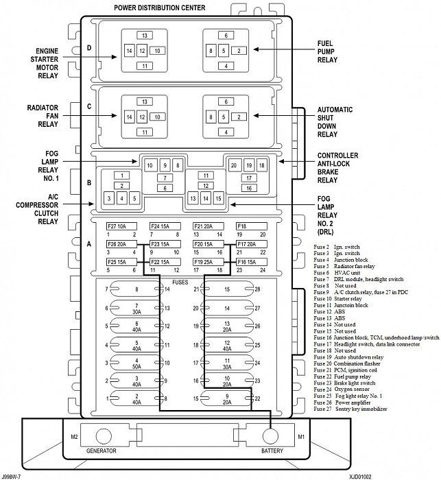

Ok. multimeter came in. The fuses themselves are good, but a couple arent getting power. This includes F24 for the O2 sensor and F21 which powers both the PCM and ignition coil. Heres an image for visual reference

Which points to what 8mud said about fuse 11 in the fuse box in the passenger foot well. Sorry I misread the previous post. Got in there and cleaned it and its all good now.
