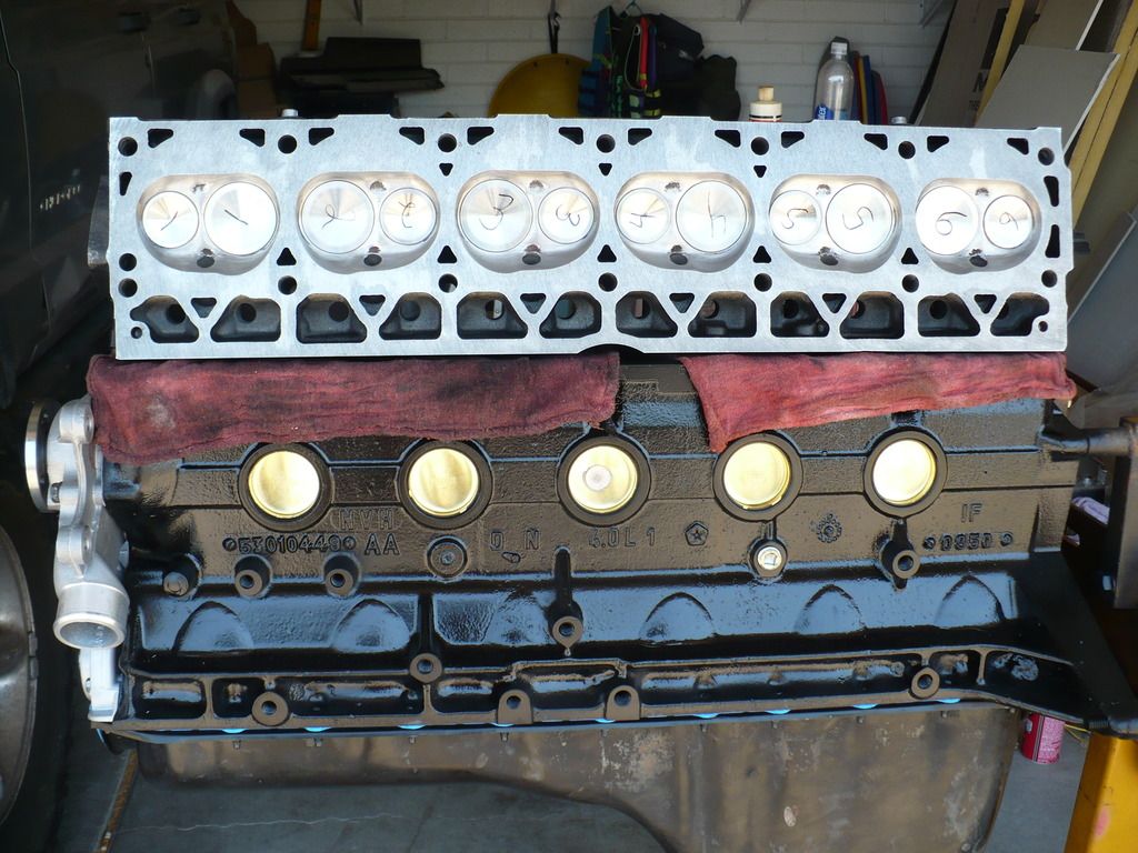

Are you able to draw an arrow on your picture of the drain holes? My head is too clogged to see any sort of holes...
  #30
Old September 13th, 2019, 17:47
RCP Phx RCP Phx is offline
Join Date: Mar 2003
Location: Phoenix,Az
Posts: 13,661
Re: Blowing smoke from exhaust
No, but it's 12 push rod holes on the bottom area(you can see the background on some)
