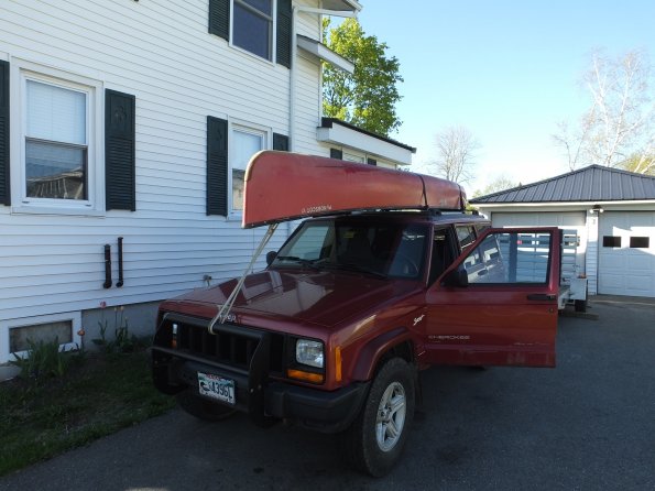

245/75r16 is working well on the current Jeep with ~2.5in lift. When I most recently replaced them I had a hard time finding that size not in 10-ply. Toyo Opencountry AT was pretty much my only option in 6-ply but I am happy with them.
I had 265/75r16 on the last Jeep with stock gears and 3.5-4 inches of lift and drove it from Maine to Moab a couple times, current tires are better on the highway and I've driven Maine to Death-Valley with this setup.
