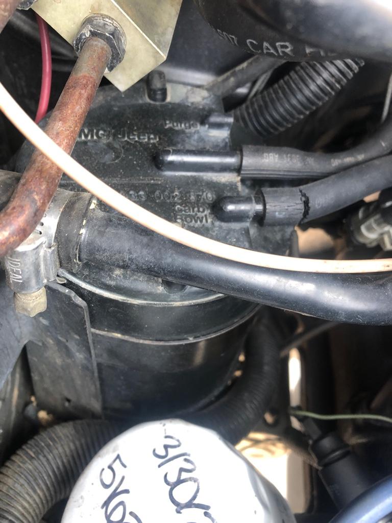

Found another leak to fix. It was at the vacuum like manifold next to the air box. Probably came off when I was installing the new steering box. It made the idle really high. Noticeably different and it actually died the first time I hit the gas. The EVAP made it pass idle CO and HC PPM. Failed High Idle CO BUT it was about 1.5% lower than the first test. Third time is a charm right?
Guy didnít check the gas tank that exploded on him last time. He said the cap worked and I told him the fix.

Broken EVAP Canister hose.
