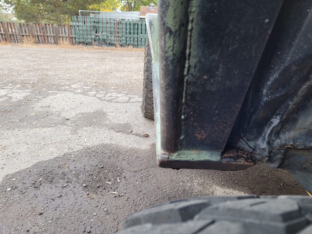

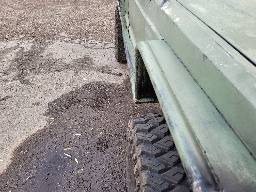

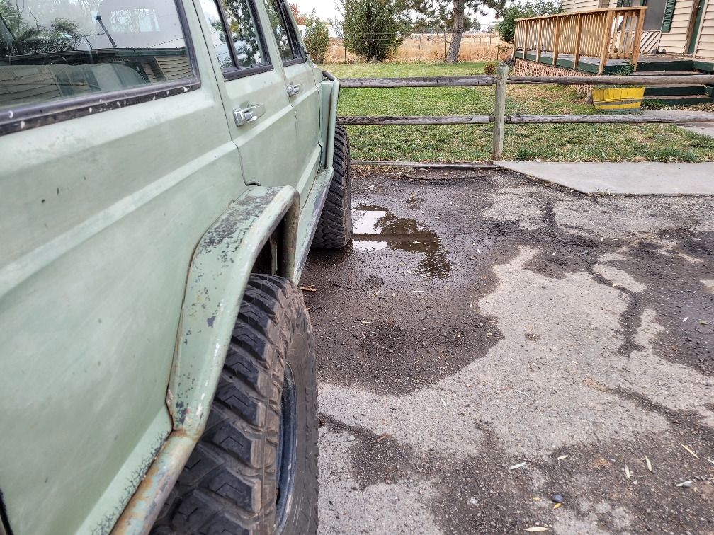

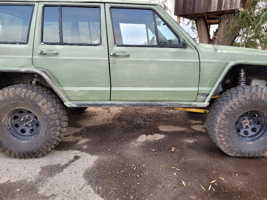

2x8 welded a lot. 2" below the doors cut out.
They get used a lot dragging the xj through rocks trees and willows one of best mods that ive done.
Can use sliders to pivot around trees that i cant really steer around 8" is just wide enough to keep most trees out of the body sides.
So far the sliders havent gotten in the way of working on anything else
2x4 looks kinda cool with tube added
