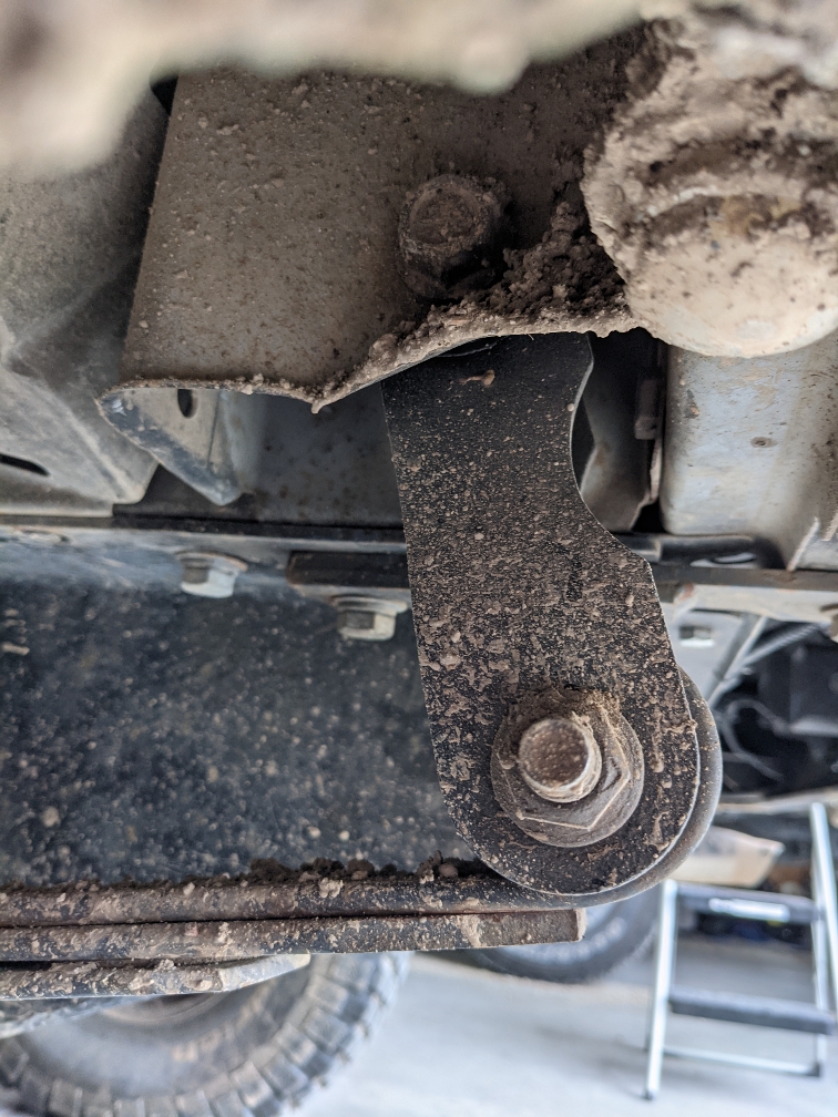

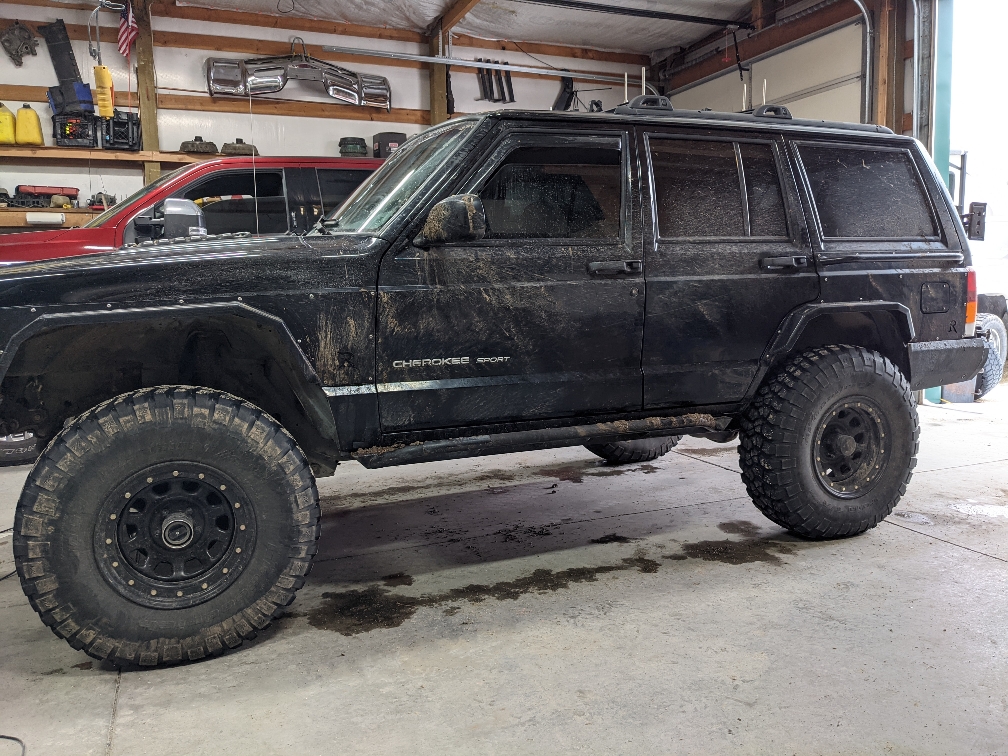

About 75*. 5.0" center-center. No body interference.
How about SRB for another 1.5" or so with existing OME 3.5" and call it good. Or am I obsessing over angle? Not after lift but considering swap to Metal cloak 4.5" up front with CAD. Round and round I go.

Your shackles are at 75 deg from horizontal now, i.e., 25 deg off vertical? Are the leaves almost flat? Mine are just slightly past vertical right now, maybe sitting at 10 deg off vertical. Is the ride too firm with OME? SRB is less money than new springs, so if you are ok with continuing to use the OME and want a softer ride with a bit more travel, then an SRB may be the hot ticket for you. Also, the rear will sit lower after the SRB unless you go with longer shackles or use an SRB that adds some lift. It looks to me that the shackle mounting holes in the SFR are about 0.5" further down than the stock location, so that SRB would add a bit of lift for no change in shackle angle.
And yes, springs are pretty flat.

Angle with extended shackle.
