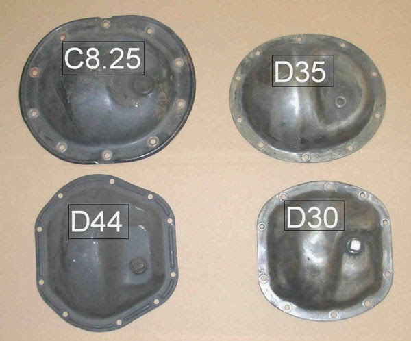

yeah i plan on doing SYE with the lift install, not gonna mess around with seeing if i can get away with it. although now i'm thinking of swapping in a 8.25 for the rear. with the 8.25 pinion, would i even need a SYE?

The difference length of d35 and a 8.25 driveshaft are less than an inch in length.
A 97 up 8.25 is a straight forward bolt in swap compared to some minor fab work of installing a 8.8.
For what you plan on doing a 97 up 8.25 will be plenty strong enough and a swap you should make if you have the d35.

31's and an 8.8 is less than an ideal combo. You'll be digging ditches as soon as you get off the pavement.
I wouldnt say "digging ditches", yeah its bigger and I agree maybe not the most ideal. If I was scrapping the 30 I'd go 8.8 over a 8.25 or 44 just my 2 cents though.
