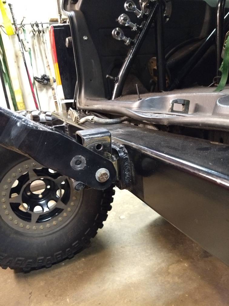

close-up of hinge setup:
pepmXETtj_6WGdQM6bFbHz3inOz1lrt-mRfW6nlYmJo4jJ6xmZ0hnE60knuxehftie8Qq31ZWTrQ0JETxHGv687cjSCFBgdYVmF2jBEWfWSMfANN_eTzLqC2ndLXYjEQCkaxkkyTLNH_80_QoZvcpGx3zCS4SEZbqSptvY_OOa0g4QZyCi9994ttr1HdX1MqO2fS4z2DgbjjcIGs7yEgHWBJJxkh2wY25IVSyNrNVxtEtDNLyVskzODXS6I8291ZweNgUZtfT4xjhlQXWvPfoQpRLgKYsLFB4331ckdHf-bhzrwTZqS894ye-HWjpAAz4psFex7KBWY3OTtcaam99zPyJ5ghzArwzJHCyGajw1Rf4qrMB4QFSE_4iwDKH0STNaCHBFKEN-NKAxqQeksk_KSjsh1JkAUi6Np5bClZEihfbDSUi3k2E96veB4LlPd3D_N261ENTXjTpyIHrHlEcb4q5Guky7kZpGxmgkvofUl0h6XtbifYkvRQAPB2jBC6oJbyd19L1aOIW8kUwCubSgsKai6kyq8nUZg2RU4SCN9Tvcstku_hgYJAyUyGxkdiDQJ1JbBZTgvxr1woZVnLvb_aK2K7CbHhkkNYQz0=w730-h941-no

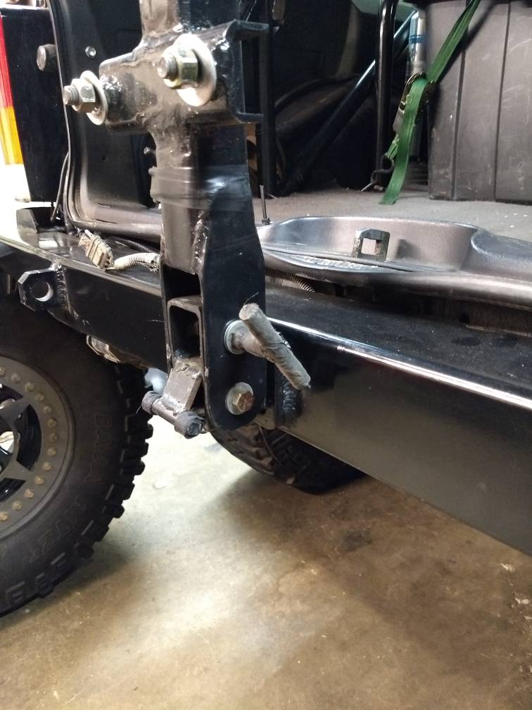

second close-up of hinge setup that shows how it mounts into existing hitch:
NypzhwEuZ0RJoUd3WBQZUfZ1mlzfBtn_HXoQcxXsvDxxdpZitir5PBse-FbGvyOe2Fe5UA9mmZFbab-jsK3kVUuV_TMcc-iaR1vRs3XvxTCwsUgI5qsMtblRZJ9eaki-pjVqYdf9OoCkQC5Jz_Ld0mta_GyWiI_q50nYg6E8fMeU0zqa-49MjtPSFyEySblfwAWSgKkTRZekErSo85vVhVbA2oyc_xAC6dNJRuh1UOvhf3AtZmN_5H_3gDEDf9d9AQQgoFMyT2_6bxgrNBi0WuUPDQeDggPe9g_9UmMPrC1d8nIuM0xcFMEK25MiU-TiHjeLiKUazG1dTC41tyz58UdAv58JRyWrt61DIladgLw8GoQpBiZbKZ4kTQeypKf8Ry1aiYvqyE2nxknSk192FehDx3v16miVu6SfsvaO_MAo_cVoEojt1VX08iTkdamZBvByxTBlTe5nTbtCXmX3JzCuP8X40cZCCs8VQLX38zwr8iELQikgSJdKhaFysn2VBEvavXzxnAcLtEyKo8coLp27-JVwu97dn8cRW1frZWLFngMpQUta0AEUr7CjcknVoVVc33U0QcbBs2odN8OAboX7XMnFHyq41d_NNs8=w800-h892-no

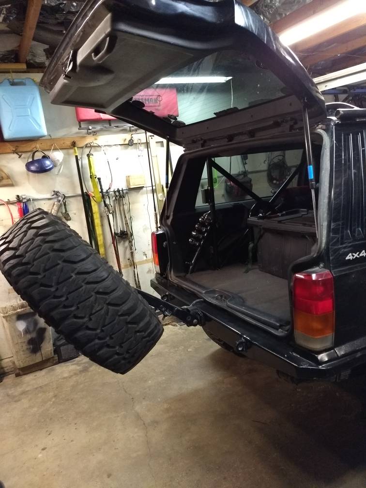

completed setup (please forgive stock spare):
yilgD42KFNWoGX2bPX6At5Q19WWK1V32AsfQDOKoo_6UXzPeGSdA7vgq0KF5wd7jJB10CWzQyxEOW3UKsWga9v3GScwEBkevzmwRKfVTd5IaZOJjYKAXKnw6_z2yp3z-OoU8-tcFRaZURIiNC1Ejt5WWw2TFxlljG0Xji07CjE_HOqQhZnjOkJGAI8dnWRCxqO4Ym7q4y8aHJSeBDdSsjTTrVFHN3uGSBHnS8Psrogkw4kYCLSDyHAxWC12VEvkZ49YUb9sfnJVeF1vcYGIYqaDTvGYd-G2YyJVStFG6TCRlOrue0s0H6s-dJh6nsSLQFRKSxHiieur8HxeUoDAeguVMTTalp2FW8K2Z9h_an824SJxYgGhcb4qe8r6OIUVxba-9FtN5ORoiNurqREyA3BltaGPCqCG7YPohvq3IPGRWW5Q-KctOktE25k3Wkc8qTNOK3w3n4cUZWaagMHnMCLrUZ5lYSZKBxT6wMzkbtZrLdf8m0VPpR7YUjkN2QDtw8BOVKYkhWBnfdMPF0GRV-zMBhMhY3bCRhhrmdDwoCDemAjeGeAmjfT8ElXXafYB8YRUoA7MlLLAv-Av4g8QRBIO6zO-HVSm2dPno7BE=w657-h941-no

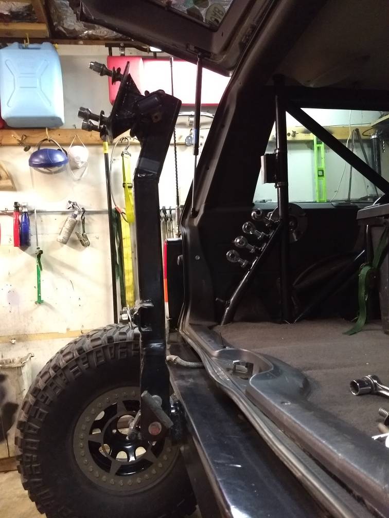

swung-down into the "open" position, allows full-functionality of gate:
7UFwpOYq2OikjoPB8bMoOsrZJQ311QLkBuuuxDOeU0AqWQb1WtkBIMwyDlJ2QEUV-iXF9c0gh6nirmWAc_lf_T39pkq0TLFk3dEALyPrfFM-YLLVSO2UQXV1ojlT-uvIF5Tw_QNCHrRbXpVGk-AekfLJL6KFeLfSlB7wg8BgA3bLLjCBUj-B1-NZUKqW8_Nsx6L7-NgxKT0f0glTvY-c1WAz16DGfPU58Q44qp1XKaeB8z36ut_ei1OqOoCPxEvL9_0FKO2-xhiInZG-LfBC08k8IrVuXRx9T69egkqm7Nr0UKZuFbs7YTliTbSl0-B-vTr7i4caUiZ9wd4Rh5fHSAfbm-3k5mc2rHZ_xZUvUCS8rva7Nm6AUd5-nKgvMfdnFM_Ia6RCFh6MP2zZVep8U9qO2u92gUtYJl0zepyj_yIPzYxRfF5OeOv5eViJYoxvw-FgP5WY0UKXc9c7ECo7wzlrAJlOVykdYIhyx7T9w7sr4xQgxjTuclhHEDsp61HM-xsOaxLlPwJUHbN5bE05nKiZUp5D3nJ-hPPa9PRCwrKO-2IltXkqxMT4hSsW_iJ1DgCQ33Jhl_j4h8h5xFgGUaTsbvesc91NOb_KbHw=w800-h698-no

The entire setup ended-up costing about $100 all told, including all materials (mostly scrap and bearings, bolts, etc.)... it just slides into the hitch tube, and I've put a through bolt with a locknut on it to secure it. Very stout, minimal blockage to rearview visibility, and doesn't obstruct the signals or license plate.
