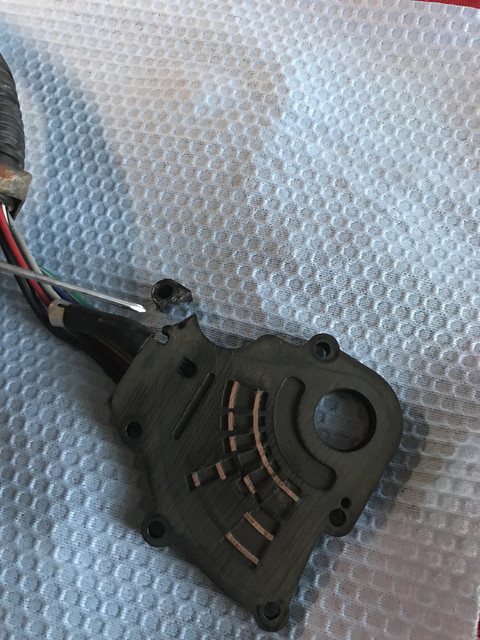

So turns out it was the NSS which was out of adjustment. I couldn’t get it just right so pulled it out to clean it. Once I pulled the case apart I noticed one of the screw hole/tabs was broken, should I buy a new NSS or just put it back in? I don’t really want to spend $200+
<a href="https://ibb.co/jGZsyqL"><img src="https://i.ibb.co/k06v4zh/C44-E75-EA-EC20-4-C66-A39-A-38212-FF21420.jpg" alt="C44-E75-EA-EC20-4-C66-A39-A-38212-FF21420" border="0"></a><br /><a target='_blank' href='https://freeonlinedice.com/'>shaking dice app</a><br />
It will work without that corner screw, just dab some RTV on the good half there
But I would get another eventually
My thought as well.
