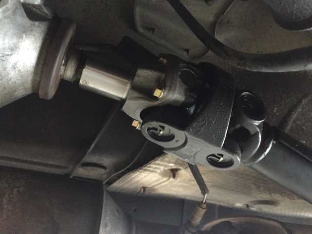

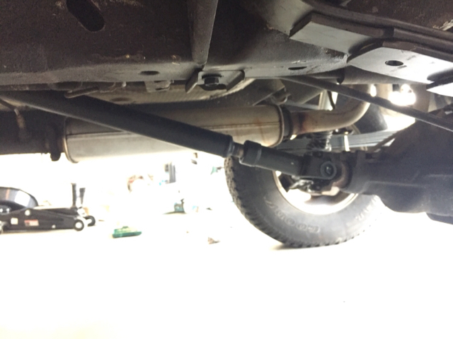

I ran the HnT on my 242 for a few years, no problems with it for street and basic trails. The driveshaft length is determined by your transmission (auto is longer than manual) and rear axle (8.25 and D44 have a longer pinion than the D35). You will need to measure the precise length to be sure.
I’m running an IRO SYE on my 99 with a 242. I went with a different seal housing. It’s mentioned on the go-Jeep site. Someone he knows makes them. I used a pick-a-part front shaft. I’m at 4.5 inch lift. Works good! Don’t forget you need to shim the axle so the pinion lines up with the shaft. I’m running 8 degrees, but with 3” you likely only need 4 or 6 degrees. IRO has them cheap and in steel. Don’t do aluminum shims.

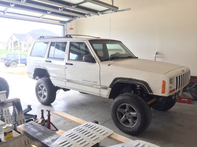

I did the IRO hack-n-Tap on my 01, 242 with 3.5" lift. Used a used front DS with 6* shims (-2* pinion angle from DS straightness for acceleration). I feel much better with that than the TC drop putting stresses on the engine/trans mounts. Plus it looks better without the TC hanging down.

I would have paid more for the slip yoke modification than I did for the whole truck, so I settled for spacers on the cross member rather than let it sit until it became practical. On that note, I also made my own coil spacers and built the leaves from stock extras. Overall, my 4.5 inch lift cost less than $35 with U bolts and spring hardware. Also, I tapered the box tubing to provide a ramp at both ends, allowing better passage over rocks, and improving the aesthetic over washers or whatever other people use in a pinch. Next time, I'll use 1x2 box.
I immediately put it overland for a 1750 mile road trip, 300 miles of dirt, and probably around twenty miles of rough trails and rock gardens. It did chew up a factory motor mount, but I also flogged it relentlessly across some rough country. New mounts are about $20.

I run the IRO hack n' tap in my '99 with a 242. Installation was really simple and it works great. I'd definitely go that route over a much pricier SYE or a TC drop, for reasons mentioned by Greenz.

I was on the same boat as you recently. This is my first Jeep so I had to learn a lot. I wanted to lift my 98 XJ to fit larger tires, but is was a daily driver also that won't see a trail. I've got atvs and utvs for that. Went with a 2 inch lift and new replacement springs in the rear which took it higher than 2". Had a vibration from the rear shaft from 20-40 mph. Was ready to do the H&T. Had the kit in hand and decided to call IRO. He suggested the tc drop instead. Glad I called. Said the front shaft would be too long to just install at 2" if lift. You might be okay 3 or above. The tc drop solved my vibes. I have a H&T kit brand new if your looking for one. Not going to use it. By the way, I found an app by TREMEC that is a driveshaft angle calculator that is really helpful in getting the driveshaft angles measured.
