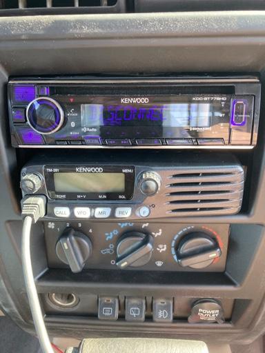

I just installed Atoto A6 pro double din head unit in my 2000 XJ yesterday, and it turned out really well!
I followed Cal's writeup here
https://www.naxja.org/forum/showthread.php?t=1131459&page=43
The double din cover is Metra 95-6554B
The hardest and messiest part of the install is the cutting of the HVAC to allow for the head unit to fit. It gets plastic dust all over the truck. I used both a cut off wheel and a dremel with a cut off wheel to get it done. My cuts were not that pretty, but they worked.
I used the included tape that the kit comes with, as well as some extra thermal tape I had laying around to make sure everything was sealed up well
It took some fiddling to find the correct mounting holes to use on the side of the head for unit for the stereo mounting arms that come with the Metra kit, so it aligned up and down and was not too far forward.
Over all I think it turned out really well! Now I just have to mess with the head unit and learn how everything works!
