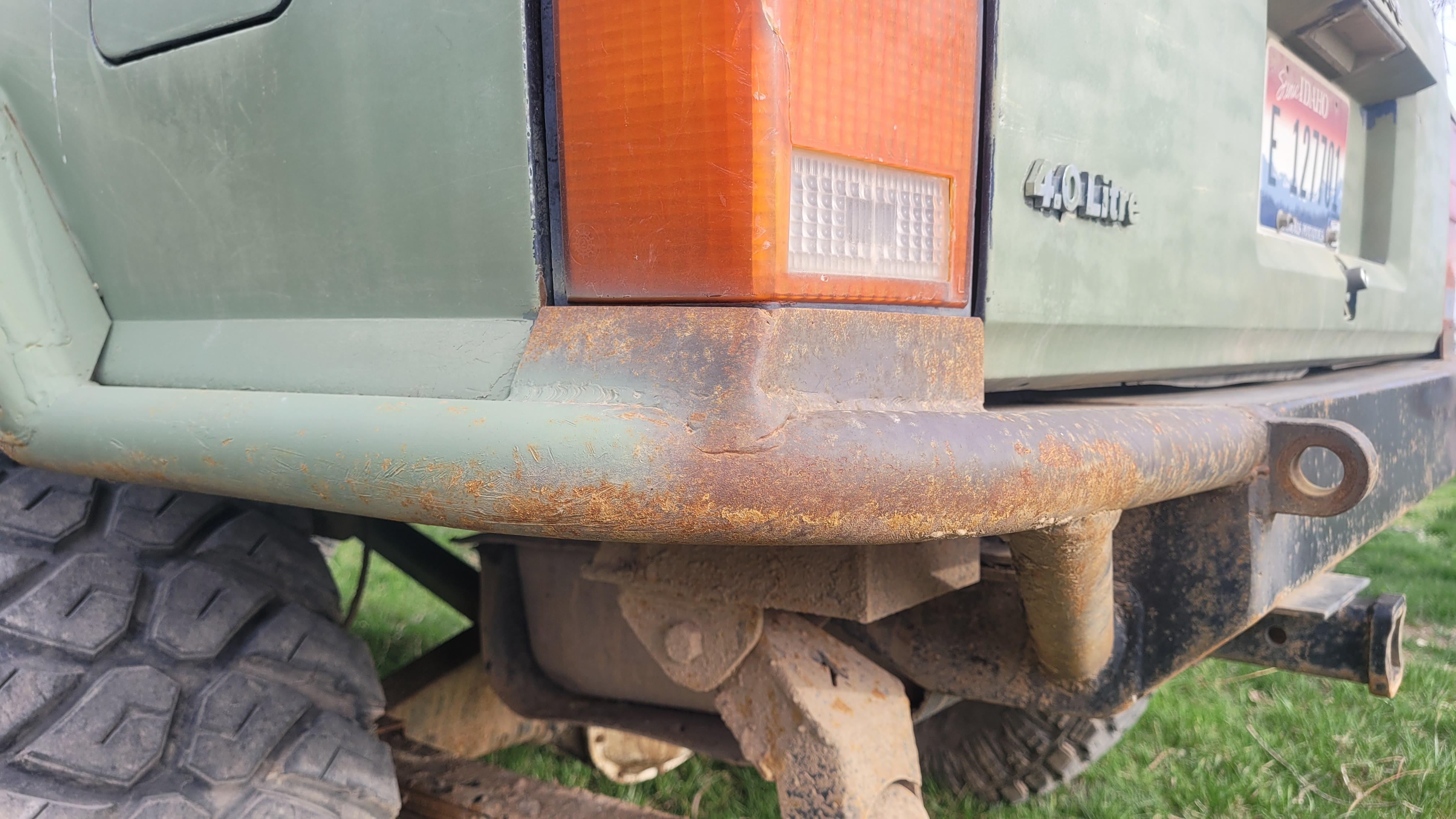

It's not what you're asking for, but here are some pictures of what I did just for some ideas.
I had a traditional cut/fold, and intended to get a wrap-around bumper to fill the gap. I decided it made more sense to have the lower quarter stay attached to the body rather than the bumper, and I wanted to retain the interior storage space.
Made these custom lower quarter panel pieces. Tied them into the bumper and tube fenders with a slider. Obviously very custom and not something you can buy/bolt on, but food for thought.

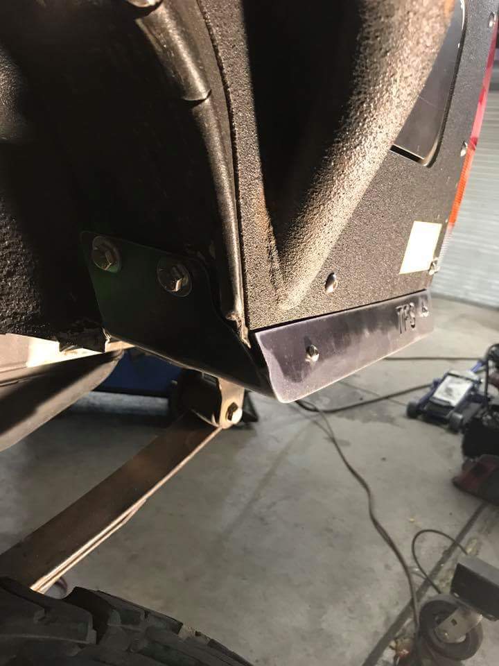

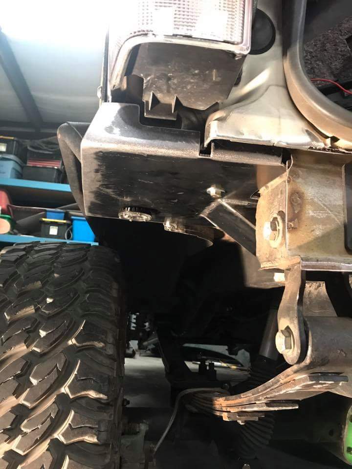

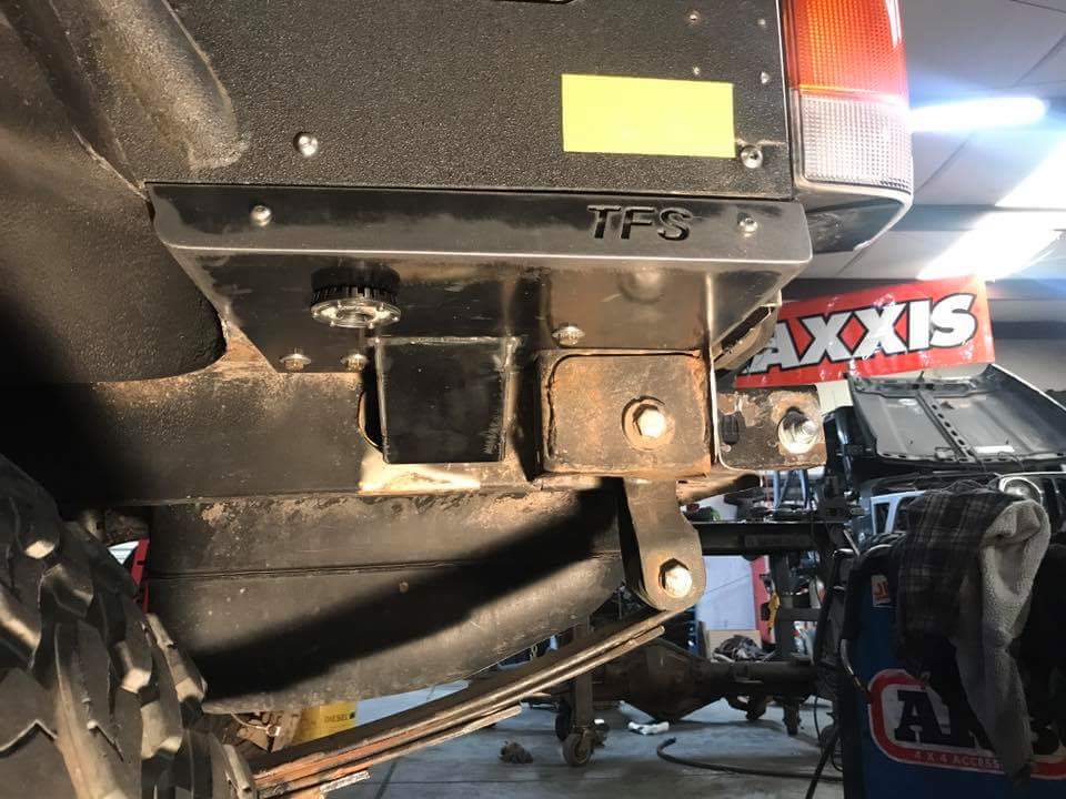

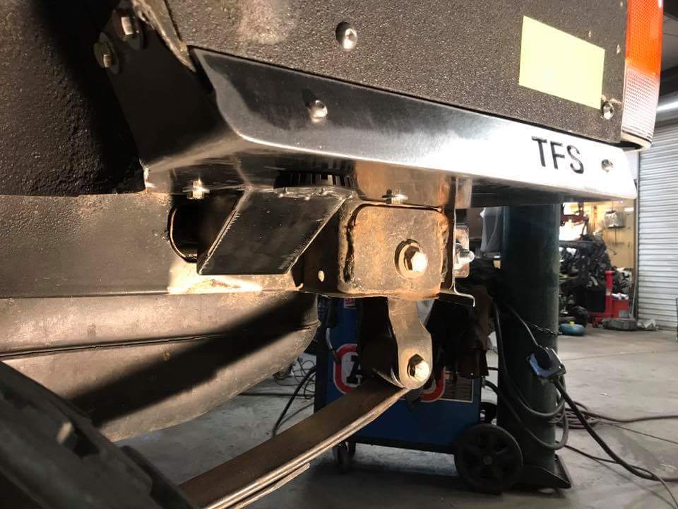

Can you attach the photo you are talking about? I'm trying to come up with a solution to this area myself and would be willing to try to find the original manufacturer as well.
Finally logged into my taptalk again so I can post the pics.
This is the company/product that I am looking for because it was cheaper than the Rustys stuff and actually wrapped up 3 sides for more rigidity.
Sent from my SM-G991U using Tapatalk
Thank you so much! I just shot him an email to see if he would make me a set. It doesn't have them listed on the website (https://the-flop-shop-offroad.myshopify.com/) but It states they do custom work so maybe they will do one set. Who knows
