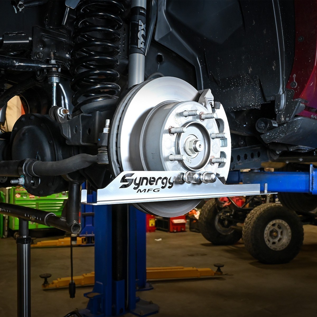

BTW,I recently picked up this tool to make setting toe even easier.

My son and I recently built and installed JK axles under his XJ, including SFR 4 Link bracketry, custom DOM links, custom DOM trackbar and steering. We aligned his Jeep in the garage and it tracks straight down the road with zero bumpsteer and handles better than a stock XJ.
