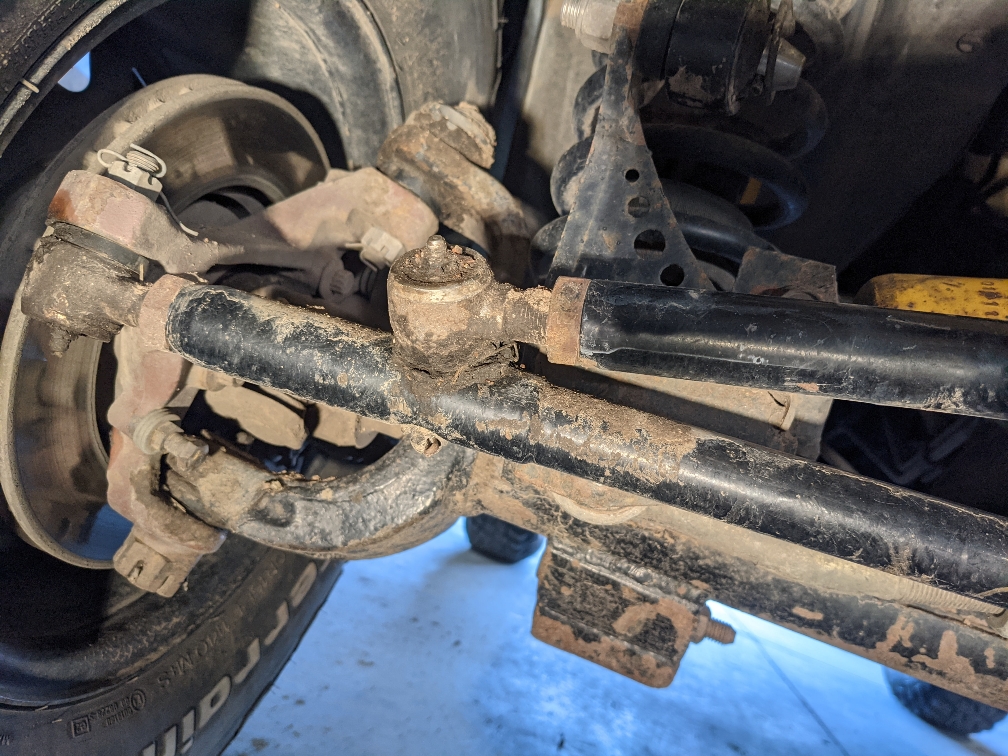

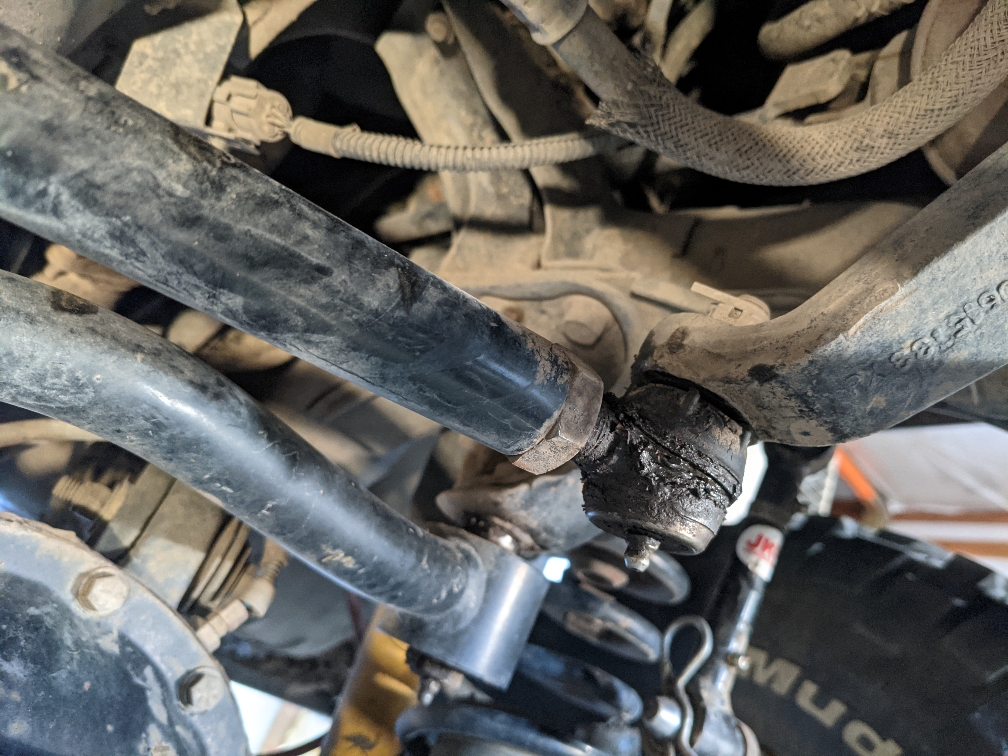

Pitman arm end (drag link?) and opposite end need replaced. Are these called inner or outer? Don't know squat here. Except that it's the part the steering damper attaches to.

That's not stock steering linkage. That's some UTK setup. As for the tie rod ends, the one at the Pitman arm either has a totally wasted boot, or it has a sliding boot setup that is not well sealed. A stock XJ tie rod end (Moog ES3096L or Proforged 104-10132) should work for the Pitman arm side of the drag link, but neither Moog nor Proforged make a right hand thread tie rod end for the other end of your drag link.

I suppose. What you probably need are 22 mm thread tie rod ends. You may have to pop off the pitman arm tie rod end to see if its been opened up for 1 ton studs.
Your best option at this point might be to order a Moog ES3096L or Proforged 104-10132 from Amazon, remove the pitman arm tie rod end, and see if the new tie rod end has the right thread pitch for the drag link and the right stud size for the pitman arm.

I'm guessing this might be the right end. No idea what brand the drag link is tho'.
With that set-up you will get tie-rod "roll", it does look like they installed the firm spacers to help eliminate the issue.

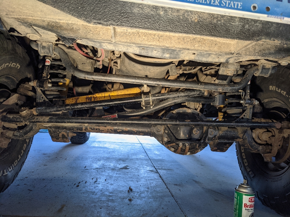

definitely not stock. looks like an old rustys setup to me. its a crossover steering/inverted T that someone flipped the LH tie rod TRE on. the tie rod goes from knuckle to knuckle, the drag link goes from the pitman arm to the tie rod.
if you are happy with it as is and simply want to replace joints... get yourself a set of thread gauges and talk to rustys. im pretty sure they have the rod ends you are looking for, but it would be good to verify. im not sure if they can offer you an OE applciation to get rod ends from. the important parts for sourcing new rod ends would be the thread size, shank length, and taper.
personally not a fan of iverted T, but it works. its just known for tie rod roll. looks like someone installed an anti roll bushing on the tie rod TREs which is a band aid fix for the inherent problems of inverted T. and flipping one end of the tie rod but not the other was a janky move. im guessing the tie rod was flipped with inverted Y steering and then the inverted T was added later. just speculation.
if you want to replace it with something OE style (inverted Y) like the curry steering, youll need to replace the drivers side knuckle, or drill it out and weld in a tapered insert. i would probably do this even if you are keeping the inverted T. under the knuckle inverted T or OE style steering or likely plenty for your usage.

the part in red is for your given trackbar setup. anything else and youll need to address the track bar as well.
You can keep the inverted drivers side with almost all the different manufacturers set-ups.
Fired off the pictures to Rusty's hoping they can ID. They have end links available for their bar so I'm hopeful.
You nailed it! Rusty's has confirmed it's their setup and they have end-links, so off I go. If I wear out another pair of end-links in a hurry, I'll replace the whole shaboom. For the time being, I'll be glad to get rid of the clunk it was causing and see where it takes me.
