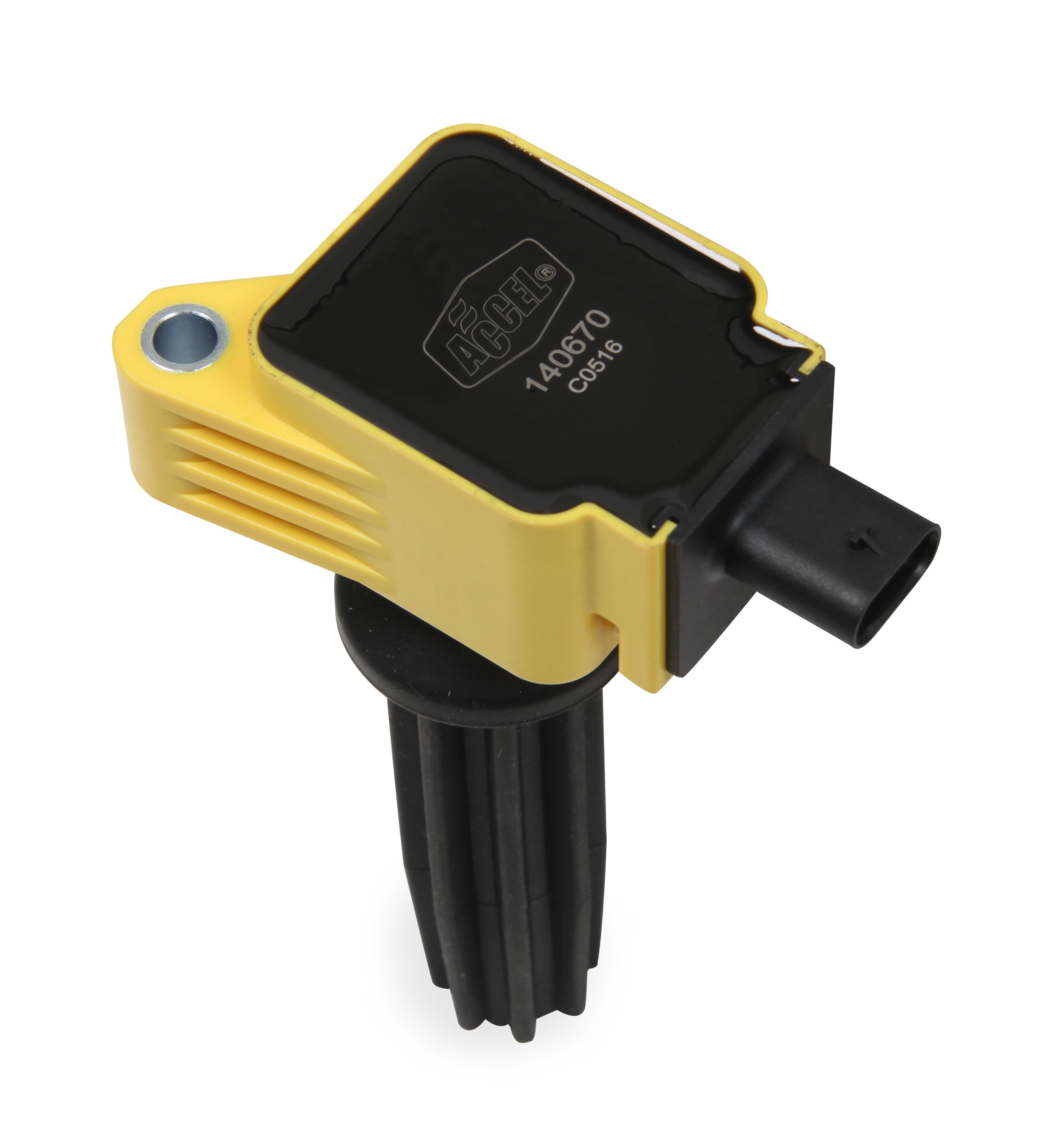

Has anyone thought about using 6 COP's? Does anyone know how the factory coils are wired(single spark, double spark, etc)?

The factory coil is wiring up in a wasted spark configuration with 3 ignition drivers in the PCM driving 3 coils. The Viper coil is the same (Even has the same connector). As for doing Individual COPs, you have to remember the factory coil is driver is integrated into the PCM, so you can't get a logic level out to drive smart coils, like an LS1 coil. But if you could managed to get a pair of dumb COPs that have the same resistance combined as the stock coil, in theory it could work.

Well I don't have any plug wires now and I prefer not to go backwards in time. Yes, resistance for most COP's is to low for the PCM drivers but, there's ways around that to. I will keep looking for a unit that will work or even look into building a power supply/splitter!
